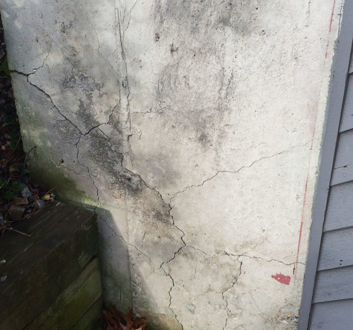

Image Credit: Connecticut Coalition Against Crumbling Basements
Connecticut authorities continue to gather information about failing concrete foundations in hundreds and possibly thousands of homes in the eastern part of the state, but there is no financial relief in sight now for homeowners whose houses are essentially worthless.
In early November, state Attorney General George Jepsen released the results of a scientific investigation, concluding the mineral pyrrhotite in aggregate used to make concrete was a “contributing factor” to deteriorating foundations. But homeowners so far have been left high and dry by both the state and their insurance companies, in part because nothing in Connecticut state law regulates how much pyrrhotite concrete may legally contain.
The state’s Department of Consumer Protection, which is conducting its own investigation, says that it has received 399 formal complaints from homeowners. But the state doesn’t know how extensive the problem is and says the number of homes with ailing foundations could run into the thousands. There also are suggestions, so far unconfirmed, that commercial properties are affected.
“The scope of the problem is a little hard to determine for a series of reasons,” said Lora Rae Anderson, the department’s communications director. “Many thousands [of houses] is definitely probable. We obviously do not have a complaint from every single person who has this problem. “
The concrete was made with aggregate mined in a quarry owned by the Becker Construction Company in Willington, Connecticut, and went into foundations in more than 20 communities beginning as early as 1983, according to the citizen group called Connecticut Coalition Against Crumbling Basements. Pyrrhotite can oxidize in the presence of water and lead to the formation of expansive secondary minerals, resulting first in a series of hairline cracks and eventually much more serious problems.
Problems may not show up for 20 years after the concrete has been placed. The coalition claims that the only way to fix the problem is by completely replacing the concrete — a process that includes jacking up the house, removing what’s there, and pouring new footings, walls, and slab.

James Mahoney, the director at an engineering research center with expertise in transportation construction materials, said that the foundation of his 1998 Ellington home started showing hairline cracking this past spring. The discovery prompted him to begin researching the problem.
Drawing on data available from a variety of public records, Mahoney developed a model predicting that some 10,300 houses were built with concrete supplied by J.J. Mottes, a ready-mix supplier in Stafford Springs that used aggregate from the Becker quarry. Mahoney estimated that it would cost an average of $150,000 for each foundation/footing that had to be replaced.
