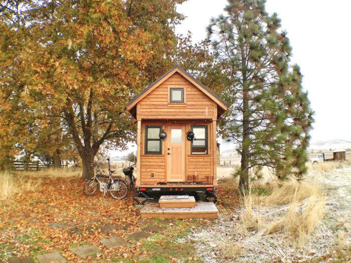

Nearly 40,000 people turned up for the first ever Tiny House Jamboree earlier this month in Colorado Springs, Colorado, for a taste of what it would be like to live in a house with a footprint no bigger than 400 square feet.
9News, a Colorado NBC affiliate, reported that visitors represented all 50 states and 10 countries. The three-day weekend festival also drew 22 professional builders who specialize in these diminutive designs.
Long lines queued up at houses as small as 100 square feet as people waited their turns to get into buildings big enough for only two or three at a time.
