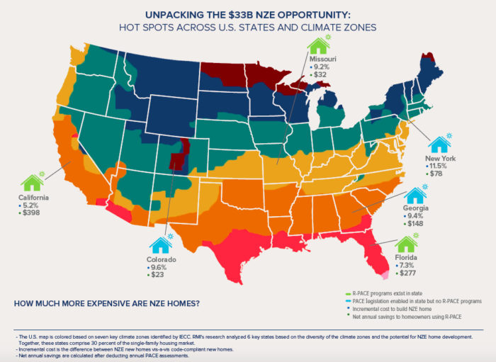

Costs and savings: This map shows the incremental cost of building a net-zero energy home in six key states, along with the net annual savings to homeowners who use R-PACE financing.
Image Credit: Rocky Mountain Institute

According to Rocky Mountain Institute’s research, the average incremental up-front cost of constructing an NZE home is likely to be $24,811 more than an average code-compliant new home (excluding the federal investment tax credit and other state-specific incentives). This estimate was derived by analyzing average code-compliant single-family homes across California, Missouri, Florida, New York, Colorado, and Georgia, which collectively comprise almost one-third of the existing single-family housing market.
