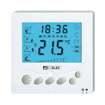

I’m a big fan of programmable, digital thermostats, which provide even more flexibility—but are also more complicated. With most programmable thermostats you can designate multiple setback periods each day and differentiate weekdays from weekends. I have a one of these in our kitchen, the primary heating zone we use, and this is programmed with four different periods each day. From 5:30 until 9 AM I usually have it set at about 68 degrees. From 9 am until 5:30 PM, when my wife and I are at work, it’s set at 52 degrees, then at 5:30 PM the temperature is bumped up to 65 degrees. Finally, from 11 PM until 5:30 AM, it’s dropped back down to 52 degrees. (In reality, because we heat with wood and our wood stove is in the kitchen, the oil heat often doesn’t kick on at all.) On weekends the thermostat is programmed with different times and temperatures, because we’re usually home during the day.
Most programmable thermostats provide handy override features. The simplest on mine are up and down arrows. You can manually increase or lower the temperature setting by pressing one of the arrows until the desired temperature shows on the digital readout. The thermostat will maintain that temperature through the end of the current time period. For example, it we get home from work at 6:30 feeling chilly and don’t want to start a fire, one of us might bump the temperature up to 70. (Because we usually keep the temperature quite low, we don’t have to feel too guilty about using a higher setting for a few hours.) If we don’t change the setting again in the evening, it will remain at 70 until 11 PM, when the nighttime temperature setting kicks in.
With most programmable thermostats you can also “hold” the temperature—so that it doesn’t revert to the programmed settings at the end of the current time period. I use this when we’re heading out of town—keeping the temperature at 50 degrees, for example.
