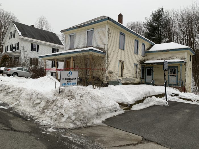

Writing in a recent Q&A post, BlueSolar says he’s not finding good building lots in convenient neighborhoods in the two areas he’s considering, Tucson and Las Vegas. So he’s thinking about buying a cheaper house, tearing it down, and building a new one.
BlueSolar can see pros and cons. On the plus side, he’ll get energy efficiency, comfort, roominess, and all the building details he wants. On the downside, this will probably cost more and take longer.
“I don’t like old houses in general,” BlueSolar says. “They tend to be ridiculously inefficient, uncomfortable, and low tech. I think landfills are fabulous, so I have no problem with sending a bunch of debris to one. I actually think a lot of houses should be torn down and replaced with much improved ones, just like that federal program that encouraged people to junk their old, high-polluting cars.”

That all depends on what you’re starting with, Akos replies. If an existing foundation can be reused it could save a lot of money. If the house is balloon-framed with clapboard siding, demolishing it and rebuilding would be cheaper than trying to make it energy efficient.
“All brick is a bit different,” Akos adds. “Tearing down and rebuilding brick is not cheap. Generally you want…

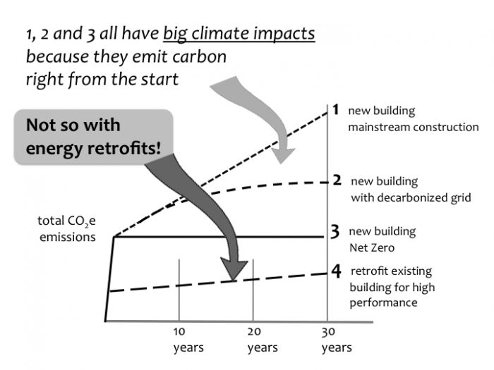

    Any sign of carbon negative builds? So the building sequesters more carbon than used in constructing it? That would add a new line to Bruce King's figure there. Very likely keeping the foundation would be key (since concrete is so high in embodied energy). Then wood throughout. Of course there is also the embodied energy of the deconstruction (and rotting of the materials in the landfill). Would appreciate any pointers to models going this direction.

      There's a flawed premise in the comparison of old vs new by GBA: new homes are assumed to be far more efficient.
      How many Net Zero new builds are now in the housing stock?! Pitifully few, if I count the examples on NREL and EPA's websites. Even fewer are Passive.
      Far more people drive EVs than live in Net Zero homes -- OK unfair apples-to-oranges comparison, I know! But how about this: both Net Zero and EV/PHEVs target the conscientious consumer, both are new, some of these cars cost FAR more than their (old) conventional gas guzzlers ... So there's a monetary point when folks say Net Zero homes aren't significantly more expensive than conventional; YET the electric car adoption has beat out the efficient home. There's >1Million EV/PHEV cars already on the road in the US.
      Again, how many Net Zero/Passive homes are there? It's safe to assume new builds are just meeting code minimum, so if someone can retrofit to code minimum, then the comparison of old vs. new is awash.
      Perhaps we should be asking more questions.

    Nice! I was puzzled by the setup on Peter Yost's example. It reads:
    But my brother took one look...
    “Tear it down and build new,” my brother advised.
    The moral: if you find an existing home you like, it’s probably worth fixing up.
    Say what? This was an apparent tear-down candidate from everything that preceded the moral. How is the moral to fix it up? I feel like maybe a stray edit deleted a key part of the setup.
      Brian Pontolilo | | #3
      I think Peter's point was that for him and his immediate family, the house had enough positive attributes to keep it and remodel. To his brother, it was a tear down. In other words, differing opinions based on the perceived merits of the house can make it a tear down to one person and a keeper to another. Maybe I read it wrong and should have asked Peter, but he comes by here often enough that we'll probably hear from him soon.
        Peter Yost | | #5
        Brian nailed my intent. We liked enough things about the house, including the mostly dry and sound basement/foundation, that we wanted to put the work into it.
        I got the impression that BlueSolar either did not or could not find a home that he liked, so that is just too much of an uphill battle.
        Thanks Brian - Peter
