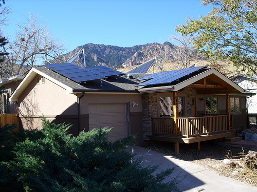

Photovoltaic and evacuated-tube solar panels on the roof provide all of the electricity and much of the heat this house uses. Extra electricity is "stored" in the local power grid and heat is stored in two insulated 168-gallon water tanks.

Intensive renovation has made this modest ranch house in the suburbs of Boulder, Colorado, an example of what all green builders strive for — a net zero energy home. Changes include an extreme insulation retrofit, a 6kW photovoltaic array installed on the roof, and an evacuated-tube solar hot water system.
The build team now expects this house to produce 130 percent of its own energy needs. A grid-tied system allows the excess electricity to be “stored” until occasional winter cold snaps require the 9kW modulating electric boiler to fill in.

  1. John Brooks | | #1
    This image is what gives pv a
    This image is what gives pv a bad name...
    If you are going to use pv..at least integrate into the Architecture. Would you buy and maintain a house that looks like that?
    I would be outraged if my neighbor did this.
  2. John Brooks | | #2
    There are a lot of good ideas
    There are a lot of good ideas in this house..It is just hard to get over the not so attractive arrays on the front of the house. Aesthetics matter...it is important to sustainability..If we love it will will maintain it.
  3. Andy Johnson | | #3
    The Rest of the Story
    This project has an extremely difficult site due to the original placement of the building in 1970 and the neighboring vegetation. The existing structure was heavily evaluated for its solar access, and due to its orientation the panel arrangement ended up being a compromise of production and aesthetics (with the homeowner wanting to maximize production). The front of the house faces just slightly north of due east. The panels arrangement without a tilt end up facing NE due to the compound angles. The other side of the roof faces west, which is the least desirable direction in our locality due to afternoon clouds and showers. The current panel configuration is the result of 4 different tries to meet production, and keep a lower profile on the roof.
    I agree whole heartedly about the need to integrate alternative energy measures into an elegant architectural design. I also believe that architectural styles and aesthetics (while absolutely important) are just ideas, and now we have this really important driving force determining what the architecture of this century needs to be about - sustainability is that driving force. As an architect faced with the need to create resilience for my clients in a post-carbon world, sometimes it means compromising certain elements. Honestly, one may not feel so bad when viewing the interior spaces and the courtyard oasis created out back of the house.
  4. John Brooks | | #4
    Andy,
    I slammed this house
    Andy,
    I slammed this house before I "looked under the hood"
    In home marketing it is all about curb apeal and "you have to get them past the front door"
    I am ashamed to say I am as shallow as some of the consumers.
    You have done some VERY good things with this house.
    Your house is an extermely high performance house even without the PV.
    John
