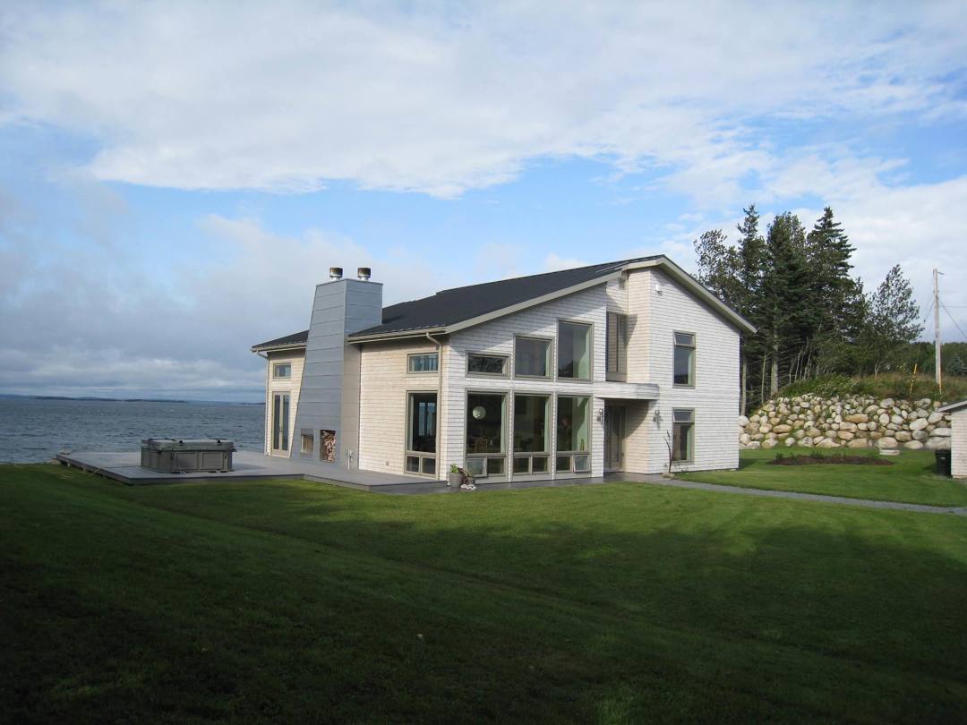

Large windows provide plenty of daylighting and passive solar heat. They also provide great ocean views.

Right on the “typical” line: 83,956 kBtu/year. But coastal Nova Scotia is hardly a typical location - when compared to local energy consumption, this is a respectable achievement. A number of strategies push this home toward energy independence. In warmer months, operable windows allow cooling ocean breezes to pass through the home’s open spaces. Expansive walls of glass let in light year round. An active solar thermal system provides domestic hot water and warms the radiant slab when heat is called for.

In a perfect world we would use the best techniques and choose the best site and every building would perform to its optimal level. Unfortunately, needs, wants, and available resources don't usually make best-case scenarios practical. Magnificent ocean views mean an exposed site with no natural shelter from the North Atlantic winds.
Taking advantage of these views demanded plenty of windows on the north side, which further complicated the construction of a well-insulated home. Solterre Design applied its passion for and expertise in energy efficiency to a challenging situation and, to the delight of John and Rosemary, created a durable, comfortable, energy conserving home.
