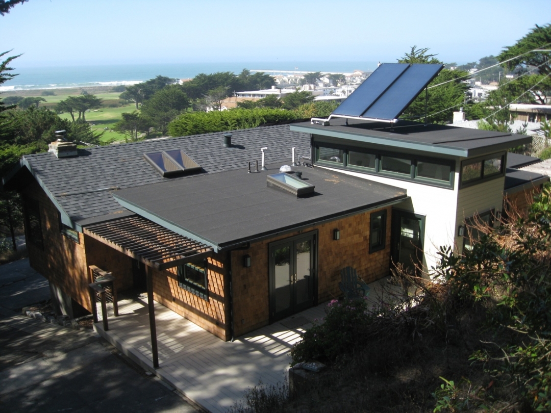

This Bay Area project features family ties to green design and construction spanning three generations
In 1938, Carl McCarthy started his “Shamrock Shack,” a small (700 square feet) weekend retreat overlooking the golf course in Sharp Park (now part of Pacifica), Calif., while he and his wife, Grace, lived 10 miles north in an apartment in San Francisco. He had virtually no building experience and no power tools.
Pat Kremer, Carl’s daughter (and with her husband, Jim, the current owners), remembers the original home this way: “It was totally uninsulated, a ‘one-butt’ kitchen (6 by 8 feet), a bed in the living room, and a bathroom — that’s it. The name Shamrock Shack was just a whim of a young Irish-American couple feeling lucky to have a weekend retreat in those days.”
Carl and Grace moved to Sharp Park full-time at the start of World War II, freeing up their San Francisco apartment to wartime housing demands. Between then and 1952, Carl cobbled on additions to the home as the family grew, until the structure had three bedrooms and two baths, with living space of 1,434 sq. ft.
The Kremer family approach to green
In 2008, Jim and Pat Kremer, approaching retirement, decided to gut and rehab the McCarthy family home as their own.
According to Jim and Pat, this was their challenge: “How do we incorporate environmentally sensitive green practices and materials, retain the tone and feel of Pat’s original homestead, yet upgrade to a modern, cozy, livable, resource-efficient home?”
More than 60 years after the McCarthys’ move-in, the home was still uninsulated and comprised a charming but not very functional warren of interior spaces, along with a decidedly dated aesthetic. Razing it would have been simpler and probably more economical, but the Kremers – and ultimately their entire team – shared a strong drive to honor both the spirit and the materials embodied in the original home.
Jim and Pat started the process by building a project team that wove together family and local building expertise. Daughter and interior designer, Alden Miller; son-in-law and contractor Dan Miller; neighbor and leading green building consultant Ann Edminster; local leading green structural engineer/building materials expert Bruce King; and energy-savvy mechanical engineer Bill Dakin of Davis Energy Group — all worked shoulder-to-shoulder throughout the project.
Their charge was this unifying theme: in design, construction, materials selection and use, weave together the history of the Shamrock Shack (green in its own right) with 21st-century high performance and resource-efficiency.
Focus: integrating the whole – team and building

Focus: energy efficiency
Jim Kremer: “It’s not easy to honor the original structure and ambiance while dramatically improving the home’s energy profile. One good example of a solution: adding a required structural ridge to the main part of the house and then building a ‘second’ roof structure on top of the first created a deep space for plenty of insulation while leaving the original rafters exposed.
“And the performance of the state-of-the-art mechanical systems matches the efficiency of the structure so that our renewable energy systems approach our reduced energy needs. We are not net zero energy, but we are getting pretty close.”
Edminster also insisted on encasing the exterior of McCarthy’s salvaged-rock chimney – a big thermal bridge in the original structure – with an insulated wall that also embraces a new window seat and media niche. Thus the vintage character was not compromised, even while dramatically improving energy efficiency.
Lessons Learned
Jim and Pat Kremer are really happy with their "new" home. But the performance of their heating system is just not what they were expecting.
Jim Kremer: "Radiant hydronic heat is highly touted and considered to be so green. But we feel it has some drawbacks for our lifestyle and our benign climate. Consider that the system has to heat up the subfloor, the maple hardwood, and in some cases a nice carpet. Under the best of circumstances, this means the lag time to respond is quite long. Unless you keep a room/zone up to temperature full-time, you have to work this lag into the heating program.
"The main living space — living Room, dining room and hallway — are all open and connected. They are served by three PEX zones controlled by one thermostat. I have been using a modest setback at night (at 10 p.m., down to 63°F) and try to heat it up for the morning (by 7 a.m., up to 68°F). Now, when the outside night temperature is in the low 50s, this works OK and it warms OK. But when we got our coldest nights last winter (low 40s — and this is not THAT cold), the system had been unable to get up to temp. Even with progressive recovery set ON with the thermostats, it does NOT bring the space up to heat during the cold snap. And during more normal winter stretches, it is taking 4 hours or more to get up to temp after the setback. If we did NOT set back at night, we could probably keep it at 68°F, but this is certainly wasteful and I am not willing to do that so far.
"The master bath — It is far from the Phoenix water heater/boiler, and the PEX runs along the wall of the Jungle, under the slate floor. It is insulated below, but unless the Jungle is up to temp, the PEX runs quite a ways in the cold slate bed before getting to the bath. So, instead of a small bath area that would heat up quickly, it is slow and very demanding of heat (a large drawdown of the water tank temp — I've monitored it) to warm the floor enough to notice with your toes.
Jim Kremer is determined to optimize the performance of their radiant system. "It's a work in progress; we will learn more about how to tune the system, balancing it's performance with our patterns of use."

• Spray foam insulation added to roof, walls, and floors
• High efficiency Phoenix gas water heater backing up a solar thermal system
• 5 heating zones with programmable thermostats
All new Marvin windows (double low-e, argon-filled) and doors
• Window treatments that modulate solar heat gain and loss
• Grid-tied PV array
• Enclosed stone fireplace to block thermal bridging
• Fireplace replaced with high efficiency Jotul wood stove insert, old chimney sealed
