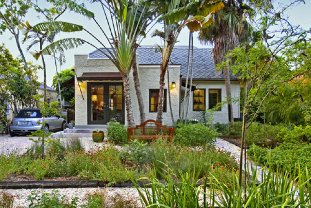

This street view of the Chael-Dover Cottage shows the front of the home. Despite a doubling in size when this home was gut-renovated, the scale and presentation of the home changed very little.
