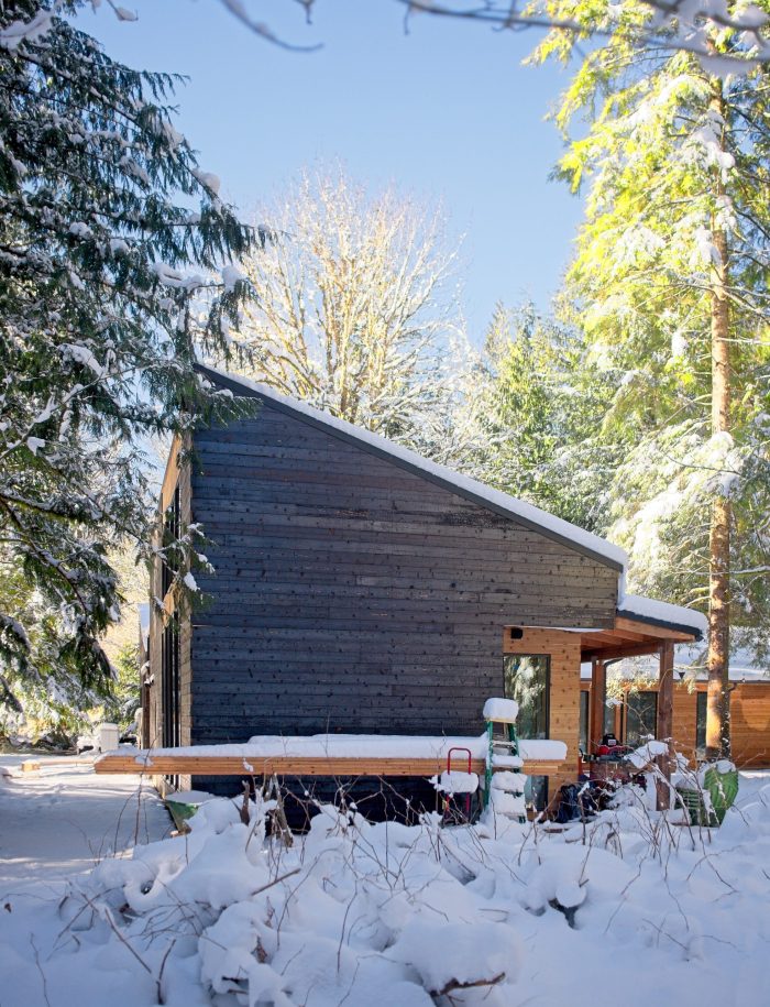

    1. ERIC WHETZEL | | #6
      The black siding is definitely an extreme, high-contrast look, which is part of the reason it appealed to us so much. We love how it looks regardless of the season, but we especially enjoy the black-box-in-snow look during the winter.
      We also considered going with a dark blue or green for our cladding, which would've given us most of the look we were going for while being slightly less stark.
      We're always surprised by the many new construction projects around us that choose to stay in the beige-brown family of tones for exterior finishes, but it's obviously a case of 'to each his own'.
      I also think the darker-toned exteriors look better when sprinkled in amongst lighter-toned homes. We would not welcome all of our neighbors copying our black for their homes :)

  5. ERIC WHETZEL | | #5
    Hi Rebecca,
    As Brian points out, although we love the look of our charred cedar siding, we've had our issues with it. I try to cover all of the details in the blog posts Brian links to.
    I'm glad Steve brought up the pine tar since it was a GBA blog (https://blueheronhaus.com/2015/08/17/siding-soffits/) that helped us come up with a solution for the deterioration of our original finish.
    In fact, if I had it to do over, after charring we would apply a coat of the black pine tar (we purchased our Auson black pine tar here: https://sagerestoration.com/collections/pine-tar) instead of the tung oil we originally used. Like a semi-transparent stain, the pine tar soaks into the wood with the addition of black pigment, all without hiding the grain (or char in our case) the way a paint would.
    The advantage of the charred wood plus pine tar finish has over just the pine tar is the texture of the char itself. By combining them together you end up with the best of both worlds: unique texture with a durable finish. For what it's worth: the areas of our siding with the least amount of char experienced the most fading in the first year.
    For interior decorative elements (e.g. barn doors, bench, light fixture, floating vanities) the char with tung oil has held up fine, looking like it did the day we finished it. Even on the exterior, the overhangs specifically, areas where the sun and rain can't easily reach, our original char-tung oil combination has held up just fine.
    Although historically the shou sugi ban tends to have wide variation in its look as it ages, the reality is most people pursue the finish because of the black color (I assume), so if it fades to gray or bare wood it would be a disappointment or even unacceptable to most homeowners. For instance, on our north side the fading was almost exclusively around knots that turned gray, which I liked, but my wife much preferred a more consistently opaque black.
