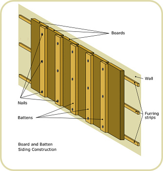

    1) What is the horizontal furring in the wall for? If you're doing board and batten siding, the boards and battens need to be nailed to the horizontal furring.

      1) From what I understand, vertical board and batten has to be nailed to horizontal furring (https://www.holoweb.net/liam/homeowner/g/board-and-batten-all-334x349.jpg). The vertical furring is to provide a drainable rain screen gap.
