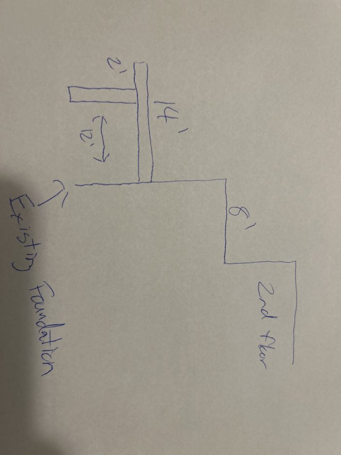

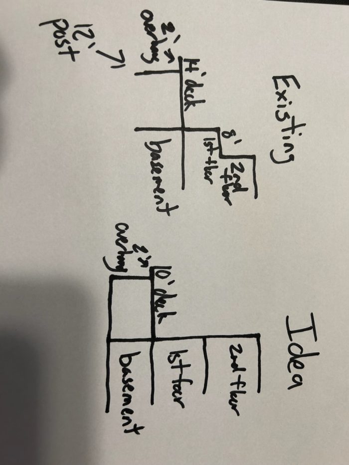

Hey hope all is well. Just brainstorming on ways to add room. My second floor is about 8 foot shorter than my first floor. Which is too short for a room. I’m considering building my basement level and first floor a few feet out to make the room and gain a few feet. My deck extends 14’ out so if I can steal some space from the deck I can gain some extra room. Underneath the deck I don’t have much head room, about 6’4, I can get a more accurate measurement but a drop beam to support both levels would be very low. If I can close in the patio I can lower the level. What would be the easiest way to do this, and preferably the most economical, picture attached.

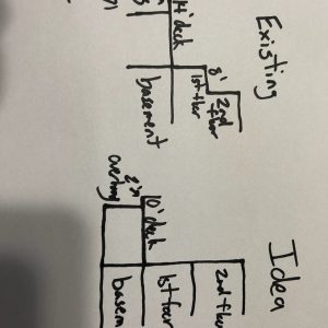

    This is true, if I can somehow cantilever the second floor at least 2 feet, it wouldn’t be a large room but enough to make a reasonable size room. It wouldn’t require the extra cost of building and digging a new foundation. I could open the first floor wall and install a large header.
    I’m no expert by any means but couldn’t you also install a post and beam with a header that is next to the existing basement and first floor? Essentially making a double wall to help support the weight.

    With 8' space there you can cantilever 1/3 so ~4' so that would get you the space you need. You'll need to add structure underneath to support the weight and your footings have to be wide enough to support the extra dead load. This would let you keep the existing deck intact which is usually not up to supporting this kind of weight in most cases anyways.
    If the existing structure can't support this extra load or be easily upgraded, you can add new posts with proper footings for support where the deck is and support the overhang.
    You'll need to figure out what your existing house structure and foundation is and have an engineer to look at the options. There are many ways of building this so definitely not impossible.

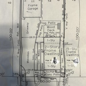

      Do you have zoning? That lot is pretty small by US standards, here you'd be pretty severely constrained as to what you could build due to setbacks, lot coverage and area ratios. That's the kind of thing a local expert will know without looking.
  8. PLIERS | | #9

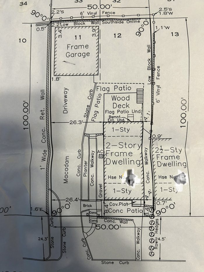

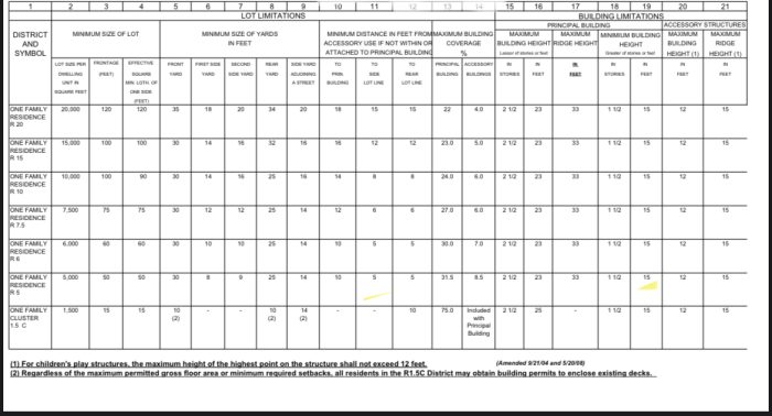

    I’m r5 in attached document, I will need a variance for almost anything. My idea was to build a foundation under the deck and make it an enclosed room in the basement. I’m talking about concrete walls when I say foundation not some makeshift support. Build the first floor 4 feet out and build up from there. I would gain 2 12x19 rooms one in the basement level and 1 on second floor. The extra 4 feet on the first floor would give me the extra room to have a dining room off the kitchen. Going from a 14’ deck to a 10’ deck is not a deal breaker for me. I may never get a variance for this or it might make everything ugly like Walta pointed out. But I remember DC mentioned some rule that you can build a basement out because it doesn’t count towards gross square footage or it by passes some building law. Anyway I made a rough drawing of idea if I didn’t make sense. Thanks for listening and offering honest advice, I may need to just sell. Again I may be holding too much sentimental value here as it’s hard to build anything on this lot.

      DCcontrarian | | #12
      OK, for R5 you have:
      Front yard 30 feet
      Side yards 8 and 9 feet
      Back yard 25 feet
      Lot coverage 31.5%
      Accessory building has to be a minimum of 10' from house.
      So the biggest house you could have on that lot would be 45' long and 33' wide. That's under the lot coverage so the lot coverage is moot.
      Your existing house is non-conforming, it's too close on the front and right side. It sounds like it was built before zoning so that itself is not a problem. The question is to what extent they let you extend existing non-conforming; zoning is hyper-local so only someone who works in your area can tell you.
      I suspect the reason people are telling you the only direction you can build out is to the side is because of zoning. Going back, if you keep the right side line you're extending a non-conforming condition. You also need to keep 10' of clearance to the garage which limits your ability to go backwards.
      I have no idea how easy it is to get a zoning variance where you are. I can tell you where I am they don't give them out easily, really they only give them if there's some special condition that prevents you from doing something you'd otherwise be able to do. For instance, on your lot you could by right build a 45x33 house if there was nothing there. But since there's a non-conforming house already there that keeps you from putting that 45x33 where it's supposed to be, they'd let you put it where the existing house is. But they're not going to let you put a bigger house or a differently shaped house.
      But your zoning board may be different.

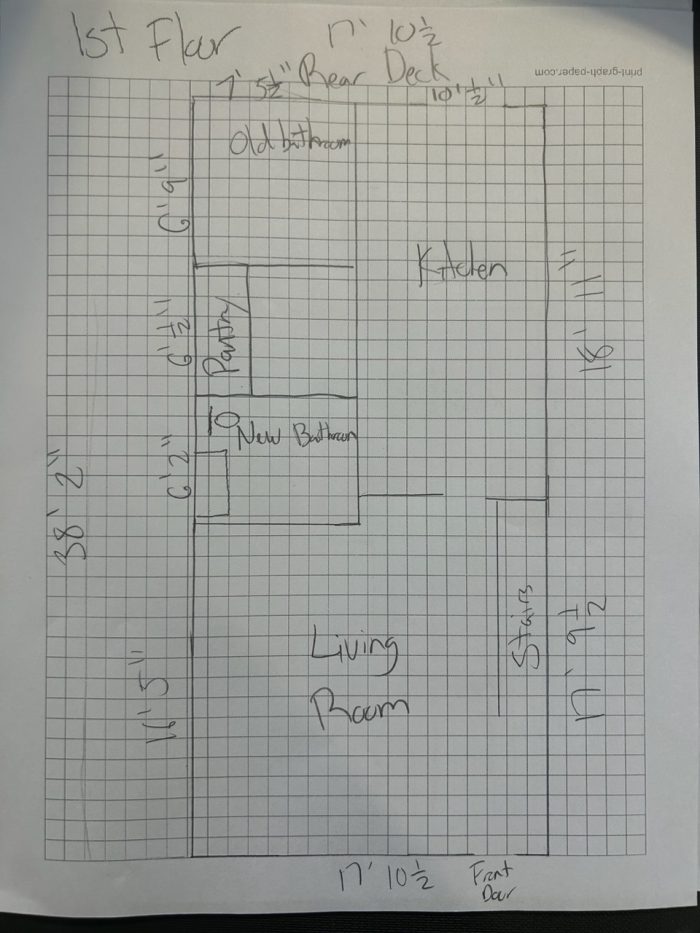

      1. PLIERS | | #13
        I’m a little confused by “ But since there's a non-conforming house already there that keeps you from putting that 45x33 where it's supposed to be, they'd let you put it where the existing house is. But they're not going to let you put a bigger house or a differently shaped house.” what does this mean? Is it hard for me to add anywhere? I know it’s hyper local but when you are non conforming where do they typically allow you to add? This is the first floor layout, what is the most logical place to put in a bedroom here? My only other idea is the turn space under the rear deck to a bedroom, but basement bedrooms are not ideal. It would be a walkout however if I’m using the term right. The rear of the house and basement level is above ground. Does that make a difference compared if it was half underground?

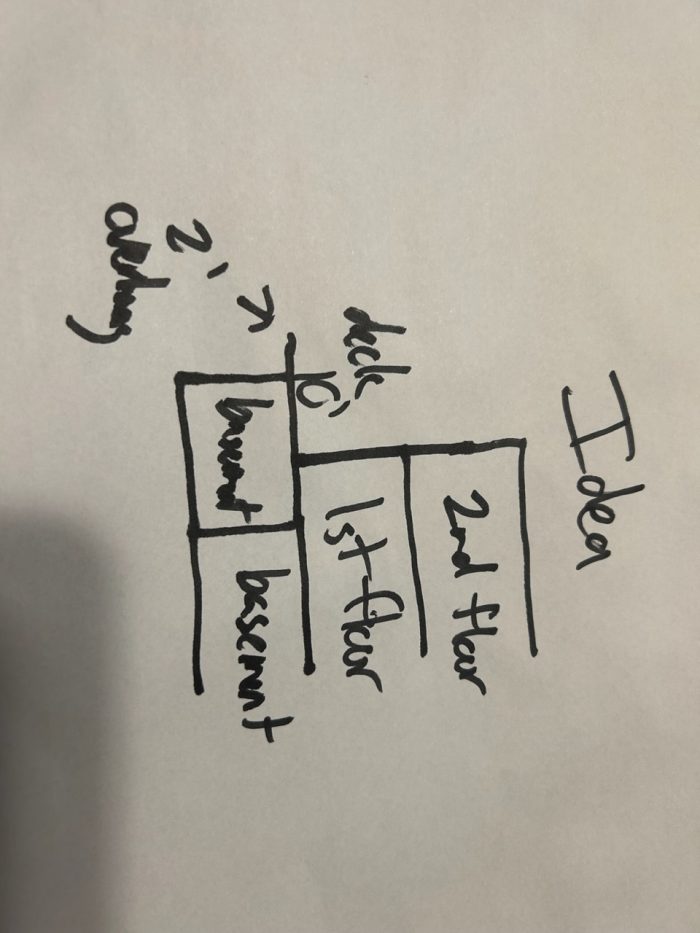

  9. PLIERS | | #10
    It would actually be more like this in terms of structure, my bad
  10. jollygreenshortguy | | #14
    You don't happen to have any framing drawings from the original construction of the house, do you?
    Sometimes it makes sense to lop off a bit before adding. It all depends on how the house was framed.
    Attaching things to attaching things to attaching things ends up with a mess. Sometimes it's best to tear back a bit and then to do a clean addition.
