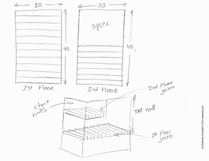

Hi guys,
I still don’t fully understand the whole “Live load”, “dead Load” thing although I do sort of get the basics. So I’m coming from the product design world, just recently starting to dabble in architectural design. I’m designing a 20×40′ small home, two stories, 10/12 roof, will be in snow country. I’m trying to spec the appropriate I-joists, so I see a local company makes a variety of I-joists for different spans, their NI-80 looks like it would do the trick, it allows a 20′ span, 16″ spacing, 5/8″ plywood, shows LL=40, DL=15…
Now, what I’m trying to figure out is, do those LL, DL numbers that are listed by the manufacture mean that’s the load of the actual product, let’s say in this case, if it’s the main floor, of the joists on the sill/foundation….. OR do those numbers mean it’s what it can SUPPORT, ie the walls, 2nd floor joists, 2nd floor walls and roof?? and in that case, how would I do the calculations to see what the actual load I’m getting onto those lower joists to see if I’m within spec.
So I’m trying to figure out if the I-joists I’m choosing are ok for this two story house design, I want to get this right before I move forward with the design. Any help with this is appreciated.
The jist of the design is 20×40, half two story, half cathedral ceiling. So in essence half of it is lofted.

    " how would I do the calculations to see what the actual load I’m getting onto those lower joists to see if I’m within spec."
    The short answer is you don't. Unlike dimensional lumber which can often be sized using either tables provided in many building codes, or calculated by the loads imposed, I-joists need to be engineered by the supplier to conform to your design. Take it in to your lumberyard. The only choice you will have to make is whether y0u want stiffer then code minimum deflection.
    That said, in your situation the main floor joists don't pick up any of the other loads you cite. The walls, second floor, and roof all bear on the exterior walls. You may need to provide blocking in addition to the rim-joists, but that is independent of the size of the I-joists, and will be detailed in the installation instructions provided by the manufacturer. The I-joists can be sized entirely based on their clear span.

          "shouldn't the ground floor get a higher load rating as it could potentially experience more load due to a 2nd, 3rd floor?"
          If you follow the load paths for the roof, and floors above they don't affect the first floor. There could be situations where they did, and that would have to be accounted for, but if the roof and the floors are clear-spanning from exterior to exterior, the only loads that get transmitted to the floors below are through the exterior walls. So they don't affect bending or deflection, you only need to worry about the ends of the I-joists getting crushed - and that's where the blocking comes in.
          Increasing the depth makes a huge difference in horizontal structural members like beams and joists. Doubling the depth of a joist means it can carry four times as much load, and will deflect 1/8 it's original amount.

            Now, just to throw a wrench in the works though, what if you had a load bearing wall/column etc. on the first floor, that helped support beam/joists on the second floor. Then I'm assuming this have to be factored into the equations. That would be a point load on the main floor joists? so would you consider that as part of the dead load? I'm assuming this is where things get complicated and maybe too theoretical for this convo....
    BILL WICHERS | | #6
    Dead load is the weight of the structure itself, live load is the weight of whatever that structure is holding up (furniture, people, etc — all the stuff you put in the building yourself). That’s pretty much all there is to it.
    Every floor gets the same load rating because that rating is for how much stuff per square foot you might put on the floor. Basically floor live loads are only for the floor in question, not anywhere else. Stuff you put on the second floor doesn’t put any load on the first floor, because the second floor is already supporting any stuff you put up there.
    Vertical loads from upper levels transfer down to the foundation through a combination of load bearing walls, where the studs carry the load, and vertical columns. Architects generally try to minimize the number of vertical columns in a building because rule #1 for columns is that they’re ALWAYS in the wrong place. Always. Furniture layout is always an issue when you have to work around columns. This is why “clear span” is a big deal in large commercial buildings — it means there are big “clear” spans with NO columns to get in your way.
