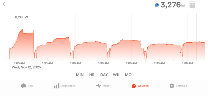

    Interesting I have similar defrost frequency and slow heat recovery issues with my ducted MXZ-SM48NAMHZ that has behaved like this for a year since install. I have been getting the run around since for a year being told this is working correctly and no resolution. Just had a small leak repair last week and recharged to spec so very unlikely low refrigerant is the issue. At 27f with high humidity I got 10 defrosts in 6 hrs. Nearly an hour of blower off completely, 2hrs at very low output and half the time blowing heat. Added temp monitors a month ago to try and figure out what was going on. When colder, below 20 cycling is similar and recovery to heating is worse so my house starts losing temp.
    Curious if your unit is cycling similarly.

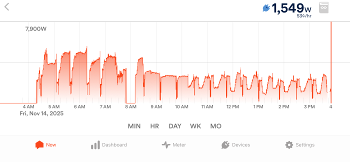

    1. markem7 | | #3
      Hi Dave, from what I can see in the charts yes it does look similar.
      You barely hit 110 F duct temp and it goes back into defrost.
      I run a non-ducted system but the behaviour seems similar.
      Defrost frequency varies, your 10/6 = 1.66 defrosts per hour, in worst cases I’ve been getting three defrosts per hour.
      I am waiting on my installer to receive the new control board and install, I will keep you posted. We have some very cold days coming up (getting close to the unit’s -13F capacity), so it would be good testing if they manage to change the card in time ..

      Akos | | #7
      That doesn't look like defrost to me.
      Typical defrost is a short pause, run at full power, short pause back to old power level. That power trace looks more like the unit cycling. A bit strange in this cold of a weather.
      1. Dave46 | | #9
        Appreciate the comment and it is definitely defrosting as the blower turns off (which it doesn't do when cycling) but agree the power usage is very strange (also didn't show power above above but near perfect alignment with supply temp or btu output). I only have 5 min resolution on power but I have a 25 min period per defrost cycle with a decrease in power usage. 15 minutes at the bottom and a 5 min period in between the high and low on both sides. Getting it looked at next week but so far no insights into issue.
