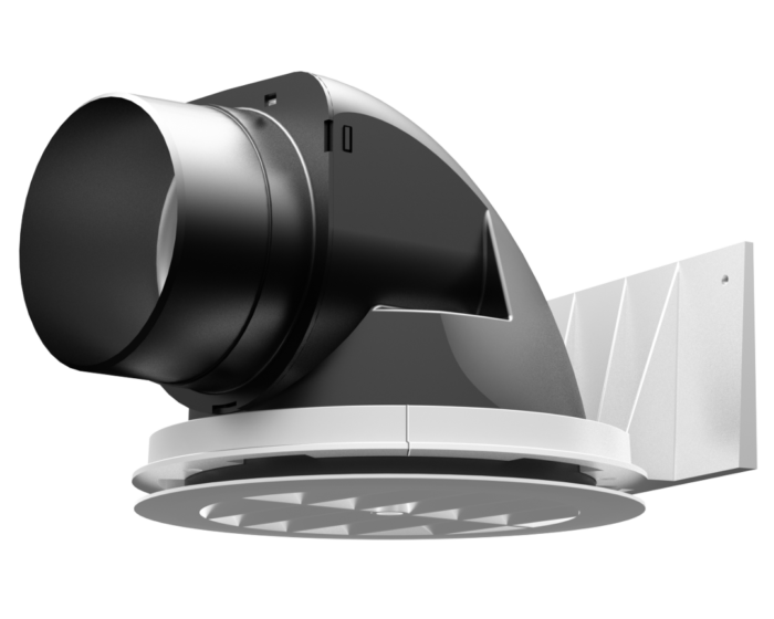

The EZSoffitVent is a plastic termination fitting for bathroom exhaust fans. It includes an integral backdraft damper.

In my article on bathroom exhaust fans, I recommended against soffit terminations: “Soffit terminations grow icicles during the winter, and allow humid air to be sucked into the attic in all seasons.” I may have to change that recommendation, however, in light of a new type of soffit termination that has been engineered to solve several bath fan installation problems.
The new soffit termination is called the EZSoffitVent (yes, with all the letters smushed together, without any spaces).
Designed for job-site realities
The EZSoffitVent limits the problem of…

    Martin: Thanks for the review of our new fitting. After years of investigating problems associated with the 'installation' of; and associated 'call backs' with the current selection of soffit mounted vent fittings, I felt it was time to develop a real professional grade installation system. The current selection of soffit terminations do not address the actual building sequence for installing a bath fan, ducting and fitting at a soffit location. This system was developed to solve several problems:
    a) The fan installer can now complete the entire system (pre-soffit) in one trip with lower total cost
    b) A better overall installation leads to better air flow improving customer satisfaction
    c) The built in air-tight damper improves Blower-Door test results and reduces cold weather comfort complaints due to cold air entry at the fan(s)
    d) Soffit discharge location does not require water intrusion protection (flashing) as does roof or wall discharge fittings
    e) Flush discharge grille is aesthetically more attractive than other options
    Spot ventilation in bathrooms is more important now than ever. It's time the process was improved for fan venting at the soffit location. We are currently working on several other new products.
