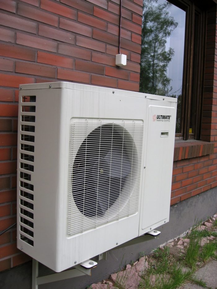

    Any installer worth their salt knows how to install the unit on the wall, above the snow depth line, and protected from roof avalanches by roof overhangs (rake preferable to eaves.) If no such overhang exists, building a small shed roof with the necessary clearances to the unit works.
    In my area we got about 10' of snow over 7-8 weeks this year. The mini-splits a friend of mine had installed on his rental property a few years ago (during a deep energy retrofit) were bracket-mounted 4' off the ground, yet more than 20' below ~1' deep eave overhangs, which was far from ideal. ( I kept recommending building additional shed-roof protection.) Unlike folks with ground-mounted units they stayed clear of snow & ice all season, without intervention.
    This is not rocket science, but apparently there aren't many rocket scientists wasting their careers installing mini-splits either. A co-worker of mine recently installed mini-splits at his suburban Boston location, and was getting push back from installers when he insisted he'd only accept quotes that stipulated a minimum of 4' off the ground , under the roof overhangs. (They ended up only about 42" off the ground, but he accepted it anyway, based on just how deep it actually got this near-record season.) Ground level mounting out in the open is fine for air conditioners, but it's stupid-on-a-stick to do that way for a heat pump in snow country.
    Cold climate mini-splits auto-defrost, and come with automatic pan-heaters to clear ice build up in the bottom of the pan. While it's important to have automatic backup for unoccupied homes, ice-up problems would not be expected. If there's an ice-up problem, the unit is defective. This is not true for all mini-splits or other air source heat pumps that people might install, but the- __RLS3H Fujitsu or -FH__NA Mitsubishi cold climate units do not ice up if functioning normally. They're designed for these climate conditions.
