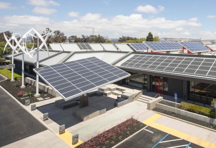

California electrical workers have renovated a 46,000-sq.-ft. commercial building in San Leandro into a net-zero energy training center. According to The Electrical Worker online, it is one of the first net-zero projects in the country that transformed an existing commercial building.
The Zero Net Energy Center, a project of the International Brotherhood of Electrical Workers (IBEW) and the National Electrical Contractors Association (NECA), will focus on energy conservation technologies as part of California’s effort to achieve its 2030 net-zero goal for commercial buildings.
The training center, which officially opened on May 30, will use a combination of helical wind turbines and photovoltaic panels to reach energy self-sufficiency. At full capacity, the system is capable of producing 139 kW of electricity, which the union says is 10% more than the building would need with “every classroom full, every computer fired up and every office in use.”
