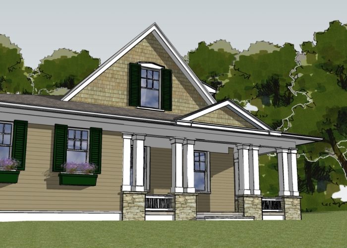

Does a Passivhaus have to look weird? The short answer is, no.

Passivhaus is compatible with traditional home styles
There are a number of architectural characteristics of a Passivhaus that facilitate performance. To keep warm here in our mid-Atlantic winters, a Passivhaus likes to spread out in the sun, and look to the south. At the same time, a Passivhaus likes generous overhangs and shutters to avoid overheating in summer.
Provision for cross flow ventilation, such as windows on two exposures in each important room, and operable skylights, can reduce the need for mechanical air conditioning during the shoulder seasons. In other words, the house could easily look like a traditional bungalow or cottage.
A Passivhaus also likes simple massing — corners, offsets, and projections present challenges to achieving airtightness, and inevitably introduce thermal bridges. In this sense, it could also be a Cape Cod or Colonial style house.
Some features fight against the grain. Our clients, the Grants of Derwood, Maryland, wanted mulled windows — but the muntin bars reduce the amount of light passing through by as much as 5%. Passivhaus cares deeply about this — when this amenity was factored into the Passive House Performance Package (PHPP), the performance fell off perceptibly.
But there was always a solution somewhere: for example, by enlarging south-facing windows or adding additional insulation to compensate for the loss of solar gain.
Are you wondering what this house is going to look like when it’s done? The rendering at the top of the page shows the Grant House. Not too weird looking, is it?
