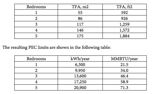

PEC limits. Passivhaus consultant Marc Rosenbaum developed a procedure for calculating primary energy consumption limits for prospective Passivhaus projects in New England based on the home’s number of bedrooms. The limits are a key focus of Rosenbaum’s proposed amendments to the Passivhaus standard.

As mentioned, the amendment makes PEC the principal focus of the New England amendment, with the PEC limit set according to the number of bedrooms — a surrogate for the number of occupants — in the building rather than setting energy-use limits according to total usable floor area. This per-person budget for energy consumption is intended to help address the fact that, under the current criteria, it is more difficult for smaller houses to meet the Passivhaus standard than it is for larger homes.
With the AHD and ACD limits eliminated, the design heating demand limit, based on treated floor area, is 30W/m2. (Rosenbaum notes that this is the limit before solar and internal heat gains are calculated, and so is not directly comparable to the 10W/m2 limit shown in the Passive House Planning Package worksheet, which shows net heating load after those gains are added.)
Other key features of the amendment: the domestic hot water limit per occupant is raised to 10 gallons per day from the German limit of 6.6 gpd; photovoltaic power can count for as much as 20% of the primary energy consumption limit (each kilowatt of PV offsets 2kW of primary energy); the dehumidification load is added; and certification is renewed annually based on energy use data.
Calculations and expectations
Rosenbaum developed an algorithm to calculate the PEC limits — in kWh per year and million btu (MMbtu) per year (see table above) — based on the number of bedrooms in the project. He also describes the processes for calculating design heating demand, annual cooling demand, domestic hot water, and auxiliary electricity and electricity for appliances, lighting, and plug loads – all as they would apply to the Passive House Planning Package program. The data, added together, show total primary energy usage, which can then be compared to the PEC limit for that particular project.
