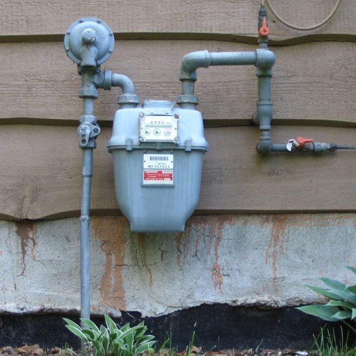

Study should focus on natural gas
A good analysis of the impact of California’s building codes should focus on natural gas use. Levinson does do one analysis of natural gas use, finding that homes built since California’s building energy code began use less natural gas than earlier homes.
However he then dismisses this finding since the trend started before the building codes took effect. He presents no evidence that prior trends would have continued, and therefore his claim that building codes had no effect is speculation.
Finally, if the objective is to examine all building codes and not just some codes, then it’s also important to look at commercial buildings. According to an analysis by Pacific Northwest National Laboratory, nationwide about 69 percent of building code savings in 2012 were in the commercial sector and only 31 percent in the residential sector.
More than 80 percent of the commercial savings were in electricity.
Bottom line: Levinson is on the wrong path if he’s trying to see the impacts of building codes. If he wants to see the forest — the impacts of codes or their absence — he needs to understand the trees. He needs to look where the impacts are supposed to be, and in California this means residential natural gas and commercial building electricity use.
