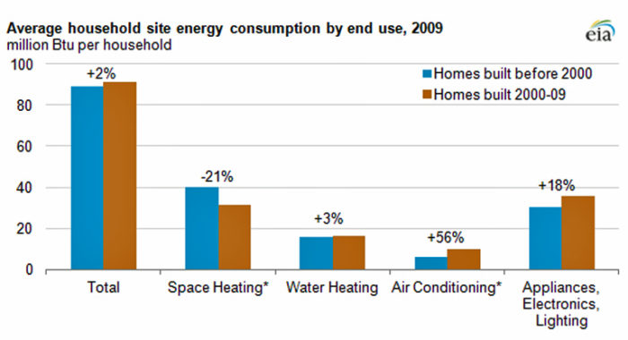

Bigger houses use more energy. This chart from the U.S. Energy Information Administration compares residential energy consumption in houses built before 2000 to those built between 2000 and 2009. Newer houses were more energy-efficient, but an average of 30 percent bigger. Total energy consumption went up.

Evidence of the Jevons Paradox at work can be found in data collected by the U.S. Energy Information Administration. The agency reported last year that newer homes in the U.S. are nearly one-third bigger than they used to be while using 2 percent more total energy — a confirmation of sorts that increased efficiencies can lead not to lower consumption but to bigger dwellings.

    Building codes dictate electronics how?
    Just looking at the graph from the article, it looks like appliances are the biggest increase, while space heating is quite a bit reduced (~10Mbtu) and space cooling is modestly up (~5Mbtu). I wouldn't associate lighting, appliances, and electronics under the jurisdiction of building codes.
    Last I checked my municipality doesn't dictate if I can have my Xbox360 plugged in at the same time as my PS4 and my WiiU, and my cable box, etc.
    Looks to me like the stuff codes can actually impact (space heating & cooling) have moved over all in a positive direction. Or has heating decreased while cooling increased because there are fewer heating degree days and more cooling degree days now than there were in 1978?

    I suspect that a good analysis such as the one attempted here is very complicated. But since the comparison was supposed to be for homes built prior to 1978 as opposed to "recently built" homes, I think the chart presented here is off the mark. Show me the same chart comparing homes built recently (perhaps the last 10 years) and homes built in the ten years prior to 1978. By the way, let's make sure the homes built prior to 1978 have not had any energy efficiency upgrades as I suspect most have had. By the way, let's not restrict ourselves to electricity use as Mr. Levinson seems to have done from my reading of the report abstract, but let's look at total energy use instead, especially if the home is not heated with electricity. And while we're considering total energy use, let's be clear that electricity used for heating and/or cooling in many cases may not be the biggest fraction of the total energy used--computers, big screen TVs, etc. As has been pointed out by others, it seems almost impossible to use the energy code as the basis for such a study since so much more electricity use is unconnected from heating and cooling associated energy efficiency today than it was prior to 1978.

    "The agency reported last year that newer homes in the U.S. are nearly one-third bigger than they used to be while using 2 percent more total energy" - a 33% increase in size of the dwelling with only a 2% increase in consumption? Sounds pretty good to me!
