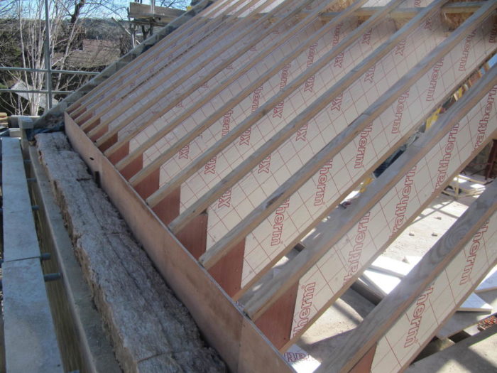

At the Golcar Passivhaus, we’ve gone for an insulated roof assembly to create extra space in the attic area, as opposed to the uninsulated roof we created for the Denby Dale project. You get the advantage of having the extra space and room, but inevitably an insulated roof assembly is the more expensive option, as it is a more complicated build.
The roof detailing at the Golcar Passivhaus is in fact similar to that at our Stirley Farm EnerPHit project.

In Stirley we used a wood-fiber vapor-open sarking board for the roof sheathing. In contrast, at Golcar we’ve used Solitex windtightness membrane (an air barrier membrane) because of the need for traditional detailing at the eaves and rakes (see Image #3, below).
To further reduce the thermal bridging of the I-joists we’ve used a continuous 50 mm (2-inch) rigid polyurethane insulation board on the interior of the roof assmbly, sandwiching the Intello membrane (a smart vapor retarder).

  • Full fill of 325 mm (12.8 inches) fiberglass batts in between the 302 mm (11.9 inch) I-joists, so that the batts compress, reducing the potential for sagging and minimizing thermal bypass problems
  • 25 mm (1 inch) of rigid polyurethane insulation attached to the sides of the I-joist webs

  10. Ken Levenson | | #10
    Happy to comment
    Great to see Bill Butcher's post. Passive House as been particularly good at increasing the trans-Atlantic building science conversation and this is a welcome development.
    Yes, we think this sort of assembly is a particularly robust approach to cathedral roof construction. Our typical assembly from inside to outside is: gyp bd finish, 1x wd furring, INTELLO airtight and vapor intelligent control membrane, I-Joists with fibrous/vapor open insulation (dense-pack or batt, cellulose, rockwool or fiberglass), SOLITEX waterproof, vapor open and airtight solid membrane, furring, then finished roof.
    This approach allows for a roof that has very high levels of insulation with robust moisture protection and airtightness. We have CAD drawings of these construction details that can be downloaded from our website: http://www.foursevenfive.com
    While this approach is still far from "common" we do see more applications of it where folks are looking for high-performance.

    Your photo makes me dizzy. I had to rotate it.
