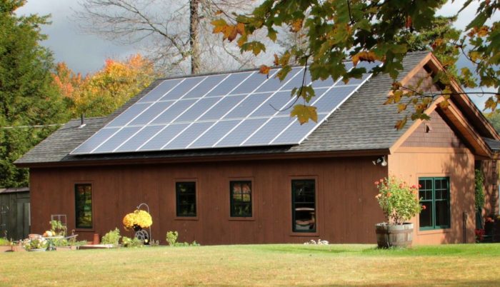

Unity Homes manufactures panelized houses designed as a high-performance alternative to conventional site-built homes. The buildings have tight envelopes with generous amounts of insulation and minimal thermal bridging.

High-performance panelized homes
Unity Homes are an alternative to conventional site-built houses, designed to be less wasteful, better insulated and better air-sealed. The Walpole, New Hapshire, company builds panelized wall systems and small, prefabricated modules for bathrooms, mechanical rooms and kitchens, which it calls “pods,” that can be assembled rapidly on site.
Walls are insulated with cellulose to R-35, and roofs insulated to between R-38 and R-44. The houses come with triple-pane windows, custom insulated doors, minisplit heat pumps, heat-recovery or energy-recovery ventilation ventilation systems, and heat pump water heaters. They can achieve net-zero energy performance with the addition of renewable energy systems, according to BuildingGreen.
Unity Homes are made with wood certified by the Forest Stewardship Council, and come with low-VOC finishes and adhesives. Components are milled with the help of computer-controlled equipment in a shop environment that minimizes waste and operating energy. Despite the upgrades in materials and workmanship over standard site-built houses, Unity Homes were said to be less expensive.
