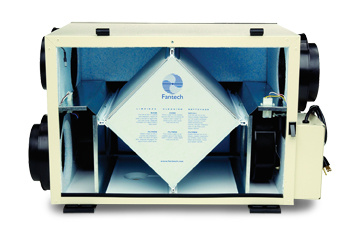

Heat exchanger: Heat-recovery and energy-recovery ventilators incorporate a heat exchanger that helps reduce energy losses. A reader in Michigan wonders whether an HRV or an ERV is the best choice.
Image Credit: Green Building Advisor
Tight, super-insulated houses need some kind of mechanical ventilation to keep indoor air healthy. Installing exhaust fans in the kitchen and bathrooms is the simplest option. More often, energy-efficient builders install either a heat-recovery ventilator (HRV) or an energy-recovery ventilator (ERV).
Both systems incorporate a heat exchanger that moderates the temperature of incoming air, which helps ease the energy penalty in both summer and winter. But ERVs also are designed to transfer some of the humidity in the air stream. And that’s what’s puzzling Donald Lintner.

    An HRV does not transfer any moisture from the exhaust air to the supply air.
    An HRV will probably recover 60% to 85% of the heat in the exhaust air stream.
