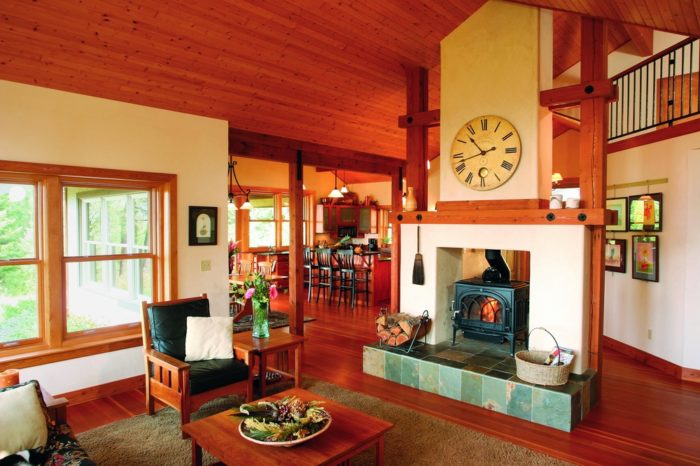

A CENTRALLY LOCATED WOOD STOVE and an open floor plan work together to heat this well insulated home. Tending a stove is not as convenient as turning up the thermostat, so homeowners have to be willing to do the extra work. On the right site, a well managed woodlot could provide a perpetual source of fuel that costs no more than the labor to cut and stack it.
