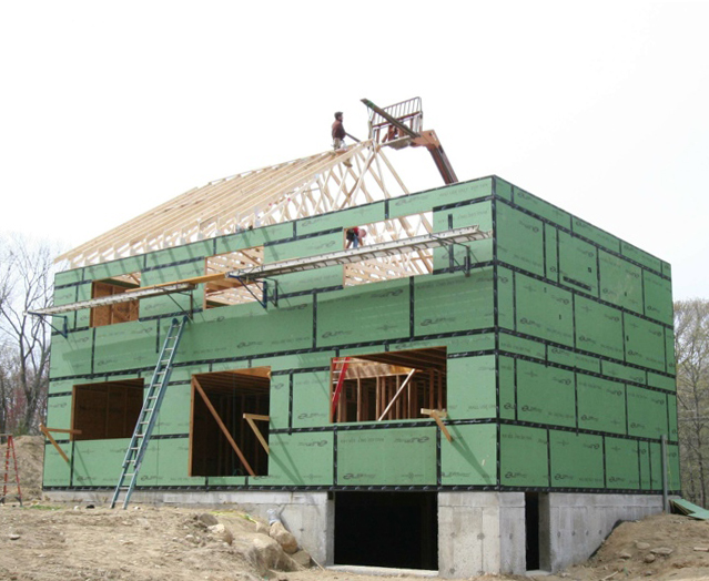

- A double stud wall consisting of two 2×4 stud walls separated by 5 inches of rigid foam insulation (4 inches of expanded polystyrene and 1 inch of polyisocyanurate) sheathed with Zip System OSB.
- Dense-packed cellulose insulation in the walls and 24 inches of loose-fill cellulose in the roof trusses.
- Raised-heel roof trusses.

Wolf went to great lengths to limit air infiltration, including the use of EPDM sill seal, air-sealing tapes around windows and on sheathing seams, and a layer of taped sheathing on the bottom of the roof trusses as an air barrier. Builders were rewarded with very low air leakage: the blower-door result was 0.34 air changes per hour at 50 pascals. That’s far below the Passivhaus threshold of 0.6 ach50.
The insulation values were equally impressive: R-28 slab, R-32 foundation, R-46 walls, and an R-83 roof.

Zip Board - Cold Sheathing Issue
Great article! Given the very thick walls, I was curious how the cold sheathing issue and condensation building up on the interior face of the OSB zipboard was handled?
Also, was the rigid insulation between the walls taped for an extra air barrier?
Drying in and out
The air tightness and the water management strategies (overhangs, rains screen, flashings) mean that we are mostly concerned with vapor diffusion in low load homes like this).
The permeability of the Zip and the hygroscopic capacity of the cellulose (and the sheathing in that it becomes more permeabie as it becomes wetter) are expected to buffer moisture flux and allow drying to the outside from any vapor drive from outside in - so yes the interstitial layer of foam is taped - but not to the exterior air barrier - and acts as vapor and secondary - redundant - air barrier). The inner wall is expected to act similarly for interior vapor drive and drying.
We chose this assembly based on the experience of my colleague Chuck Silver and study he had done with a modeling tool that Owens Corning offered to do basic hygrothermal modeling in which this "sandwich wall" fared the best of a series of assemblies he modeled.
I believe that there is some debate about this capacity among building scientists, thus the desire to better understand hygrothermal dynamics with WUFI and field monitoring as we go forward. I'm looking forward to more conclusive data and guidance on the performance of zip and densepack because we like building this assembly.
