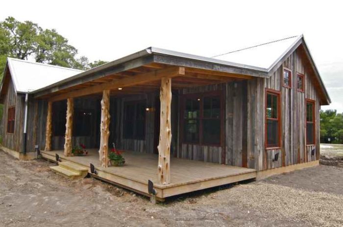

In Texas. Dubbed the Zero Energy Casita, this two-bedroom home features a shell built with structural insulated panels. The builder, Ferrier Custom Homes, also used reclaimed beams and barn siding to make house look like a longtime fixture on the Fort Worth landscape.

Placement on the site – a lakefront property – aimed to make the most of passive solar gain in the winter, shading from existing trees in the summer, and views of the lake. Ferrier used structural insulated panels made by FischerSIPS, based in Louisville, Kentucky, for the Casita's exterior walls and the roof. Ferrier Custom Homes says it used advanced framing techniques throughout the interior. The siding and most of the interior beams are reclaimed wood. Weathershield Zo-e-shield 5 windows – double-pane and gas-filled, with low-e coatings – are used throughout. The clients opted for a reflective Galvalume standing-seam coated-steel roof, which, the builder says, reflects 70% of the sunlight that hits it. The Casita’s source of renewable energy is this pivoting Skystream wind turbine, which stands 45 feet tall. The turbine blades are curved to minimize noise.

Don Ferrier, president of Ferrier Custom, favors the use of structural insulated panels for exterior walls and roofs on his projects, and this one was no exception. FischerSIPS, based in Louisville, Kentucky, produced the panels. The siding, however, departs from what’s typically found on a new house: the clients “wanted the house to look like it’s been there 150 years,” Ferrier says, so he used reclaimed siding for the skin and used salvaged flooring and 8×8 barn beams for interior finishes.
