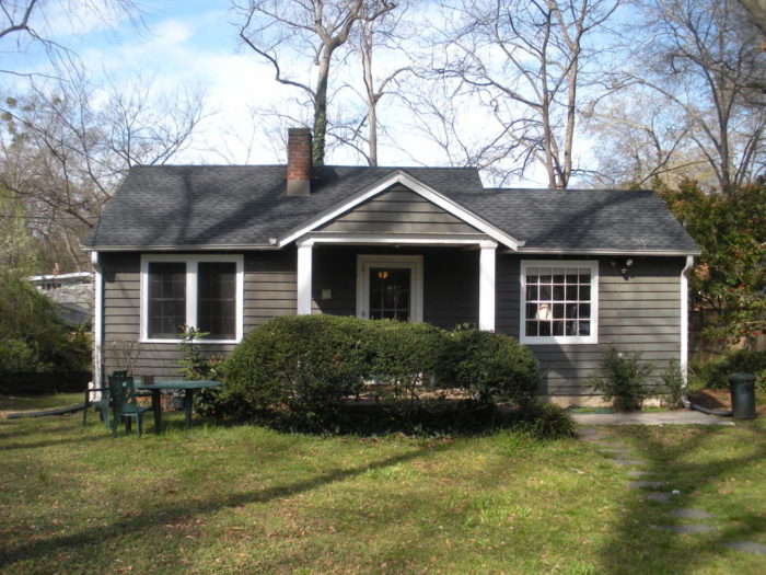

As requested by a faithful reader, I have attached a photo of the front of the house. There will be no changes to this elevation, all the work is on the rear and sides.
View Gallery 6 images
As requested by a faithful reader, I have attached a photo of the front of the house. There will be no changes to this elevation, all the work is on the rear and sides. Instead of building a new home, I'll be building an addition on my house. The new office and storage area will be placed in this corner of the house.

After paying for two home designs, with one turned down and one approved by the local historic commission, I ultimately decided not to build a new house, mostly for financial reasons. Instead, I am renovating my existing cottage and adding a small office, a storage area, and a screened porch (an excellent feature in the South).
The financial reason that I’m not building a new house is that I’m unable to obtain a mortgage for construction. It has been a while since I applied for one and, apparently, you now need not only a pulse, but you actually have to show that you earn enough money to make all the payments. I’m self-employed, and while I have what feels like a very comfortable lifestyle, the banks didn’t like my position enough to lend me the money.
Holding the conditioned area to 800 square feet
So, looking at my options, I came to the conclusion that fixing up my existing house made the most sense. It is small (750 square feet), but having lived in it for almost eight years now, I realize that I don’t really need much more space, nor do I need to increase my debt at this point in my life.
My goal is to keep the house small enough that it could be the accessory building for a future new house in the front of the property. This required me to keep the conditioned space to a maximum of 800 square feet, although I will be able to add unconditioned storage and porches. I did consider making it larger, but I didn’t want to limit the opportunities for the property, either for myself or a future owner.
The plan is fairly simple: an office and storage room will be added at the back, the kitchen and bathroom will be renovated in place, and a porch will provide very useful year round unconditioned living space and shade the west-facing kitchen windows.
