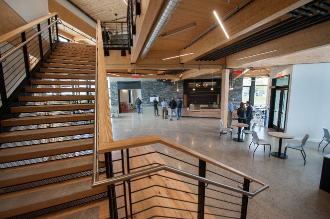

The post-and-beam components of the Kern Center at Hampshire College in Amherst, Massachusetts, are part of a "Ready List" developed by Wright Builders Inc. The list identifies products that can safely be included in Living Building Challenge projects. The timber parts were manufactured by Nordic Structures.

Glue-laminated post and beam by Nordic Structures
The post and beam structures inside the Kern Center and the Hitchcock Center are made from black spruce lamination sustainably harvested in Canada. Nordic Structures can make a structure in any shape as long as it can fit on the bed of a truck. Both buildings took advantage of this sustainable and beautiful product. Design, fabrication, and installation were done by Bensonwood for the Kern Center and Architectural Timber and Millwork for the Hitchcock Center.
