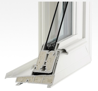

Dual-pane windows with a vinyl frame. Serious Energy’s 600 Series vinyl windows include versions with whole-window U-factors ranging from 0.14 (for a fixed picture window) to 0.30 (for a double-hung model).
