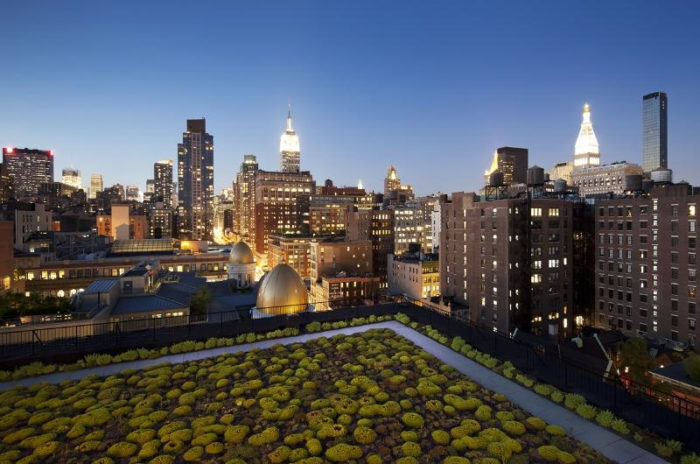

In a recent study conducted by the University of Notre Dame’s Environmental Change Initiative, we examined whether green roofs, which are covered with plants, and cool roofs, which are surfaced with reflective materials, could reduce UHI effects in Chicago. These roofing strategies are widely used across Europe and have recently been adopted in multiple U.S. cities, including New York, Los Angeles, Chicago and Portland, Oregon. Developing cities in Asia, such as Indore in India are also implementing cool roofs to mitigate UHIs.
We found that these roofing strategies did reduce the urban heat island effect, but their impacts were not uniform within the city. They also reduced breezes from Lake Michigan and altered regional air circulation in ways that could offset some of their cooling and air quality benefits. While the roofs still had a net cooling impact, urban planners will need to understand impacts on energy consumption and air quality to maximize benefits from installing green and cool roofs.

First, the impacts of green and cool roofs on UHIs varied at different locations. We found that green and cool roofing strategies reduced daytime peak urban roof temperatures across the Chicago metropolitan area by about 2-3° Celsius. However, in downtown Chicago they lowered roof surface temperatures by 7-8° Celsius. This dramatic difference indicates that green and cool roofs are most efficient in highly urbanized areas.
