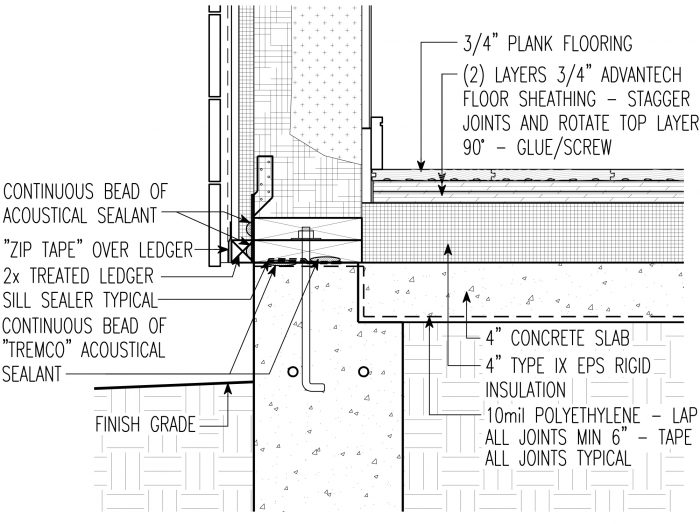

Planning a new house in Pender County, North Carolina, Jason Dennis finds the aesthetics of a crawlspace appealing, but not the potential problems. Instead, he’s thinking of pouring a slab over compacted fill inside his foundation walls — a raised slab.
The Climate Zone 3 house will be a simple rectangle, 50 feet by 39 feet, with a wraparound porch on two sides.
Dennis wants to know whether the raised slab approach is a good idea, and how such a foundation should be insulated.
“Would insulating the slab be necessary for my climate zone?” Dennis asks in a Q&A post. “If so, how should insulating be done? Rigid foam underneath like with a non-raised slab?”

In referring Dennis to an earlier article on this topic, GBA Editor Martin Holladay says it’s possible to eliminate the horizontal insulation underneath the slab. But in Climate Zone 3, Dennis should not skip the vertical insulation at the slab’s perimeter.
Holladay had written: “While it could be argued that insulation might be useful in Climate Zone 3, it really isn’t needed in warmer climates, where an uninsulated slab helps lower air-conditioning bills compared to an insulated slab.”
How deep should the insulation go?
If Dennis adopts that plan — rigid insulation vertically against the inside of the stem wall but no insulation underneath the slab — the question becomes how far down the insulation should go.
“The insulation should extend down to the footings, or if they end up being very deep, a couple of feet below the exterior grade,” Malcolm Taylor replies.

  1. RedDenver | | #1
    In the last image without the concrete slab, is there any reason to put the poly under the stone pad as opposed to on top of the stone and under the foam?
      MALCOLM TAYLOR | | #2
      Jason,
      I can think of a couple of reasons it would make more sense to move the poly as you suggest.
      - It allows the rock to act as a capillary break below the vapour barrier.
      - It raises the vapour barrier relative to the surrounding grade.
      Martin Holladay | | #3
      Jason,
      Here's another vote in favor of moving the polyethylene up to a position above the crushed stone. That way, any water droplets in the stone can drain downwards.
      1. RedDenver | | #4
        Playing devil's advocate, is there a reason to not put the poly in contact with the foam? Like could trapped water cause mold or smells?

    I'd be careful not to build any of those with low perm flooring (like vinyl or tile). Without drying to the interior, the OSB is likely to rot.
