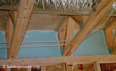

Airtightness opportunity. Floor joists draft-stopped over the top of a wall separating the interior garage perimeter from the house. This typically is a prime location for air leaks.

In commentary recently posted to the Building Science Corporation website, building scientist Joe Lstiburek takes a stroll down memory lane and reflects on his attempts in the early 1980s to help develop an airtightness standard for residential construction in Canada. Later, after signing on with production builders in the U.S., he launched a successful campaign to plug “big holes” in the envelopes of the homes these builders were constructing so that the finished products would be more comfortable to live in.
“I picked one of the big builders’ worst divisions in terms of comfort complaints — it turned out to be Chicago — and focused on making the comfort complaints go away. Notice, energy had nothing to do with any of this,” Lstiburek writes. “I figured that if they got rid of the big holes, the comfort problems would go away. The list of big holes was pretty easy to compile. Bathtubs on exterior walls, fireplaces and chimneys on exterior walls, garages attached to houses with bedrooms over them, cantilevered second floors, interior soffits dead-ending into exterior walls, and dropped ceilings under attic insulation. Done. Make these go away with draft-stopping and, presto, the comfort problems would go away.”
