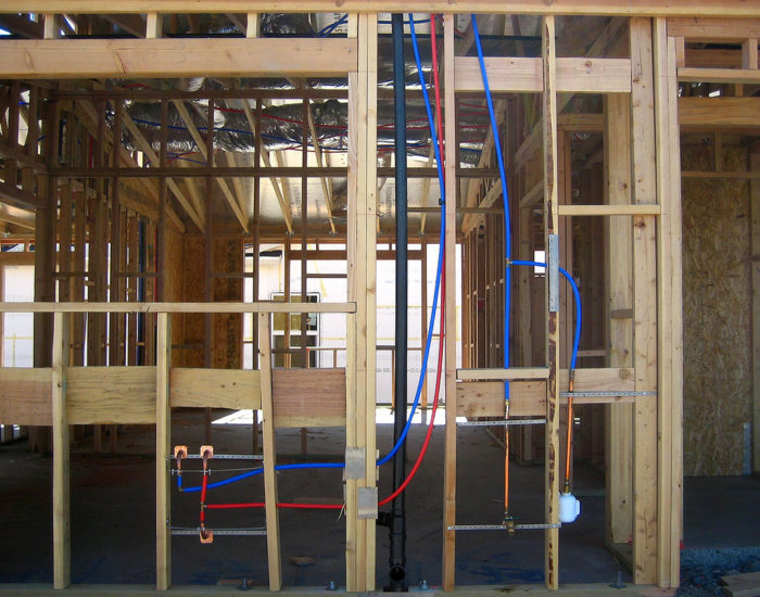

I was told to only use copper ties with copper pipes and fittings--unlike what's shown in the first picture.

They make special fittings to go from sweat for copper to crimp for PEX. They have all sorts of combinations for the different types of PEX crimps and copper, including compression fittings.
They also make extremely cheap snap on metallic 90's to help guide and hold the PEX in-shape for a 90 degree bend.

Oh... and someone needs to get that framer a level.

My guess is that the worker who was tightening the anchor bolts whacked that stud to one side to make it easier to swing his wrench. When he was done tightening the anchor bolts, he forgot to whack the stud back to where it belonged.

Like the plumber who only protected half the lines with plates where they go though the framing. Must have been a Friday afternoon job.
