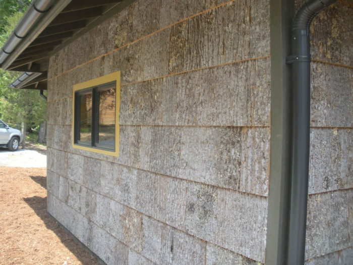

Our next stop was a self-described “outrageously green” home from Chandler Design-Build, built by Michael Chandler (a Green Building Advisor and friend), and designed by Beth Williams (his much better half). This house featured locally harvested bark siding, a radiant heating system powered by evacuated tube solar collectors, ICF foundations, and a combination of spray foam and blown-in fiberglass insulation. The energy-efficient features combined to give this house a HERS index of 58. Fun design features included goat fencing used for deck rails, lots of reclaimed wood on the interior, and a set of clerestory windows around the main living area.
