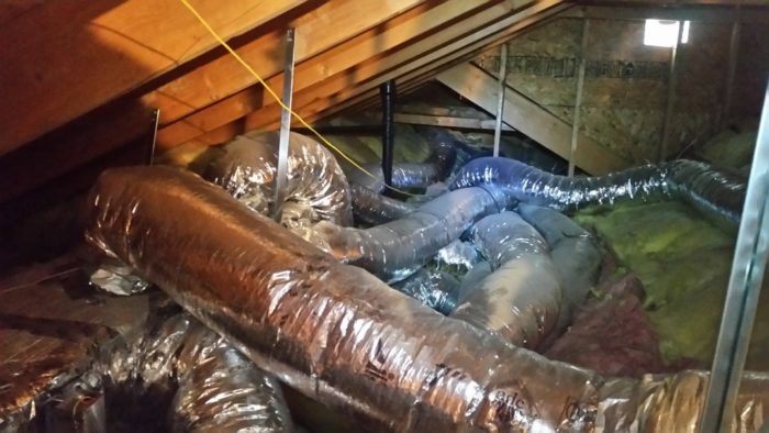

An energy audit on BuildingNewb’s upstate New York home has prompted a recommendation that he insulate the rafter bays with dense-packed cellulose, transforming what is now a ventilated attic into conditioned space.
The HVAC equipment that’s already in the attic would then be located in a conditioned space, Newb writes in a post at GBA’s Q&A forum. The contractor has suggested that existing vents at the ridge and soffit be maintained, but apparently doesn’t see the need for any ventilation space directly beneath the roof deck, which is completely covered on top with Grace Ice & Water Shield, a peel-and-stick waterproofing membrane.
“The contractor told me that when cellulose is dense packed to the proper density, air and water vapor shouldn’t be able to easily get through it from the interior,” Newb says. “In the event any moisture does get into the cellulose, it will disperse throughout the material and find its way to the openings at the soffit or ridge rather than trying to diffuse through the wood which obviously has a vapor impermeable membrane on the other side.”
Newb says that air-sealing the attic floor looks like it would be too complicated, in part because of the three cathedral ceilings that terminate at the attic.
His contractor’s approach should yield R-35 of insulation between the 2×10 rafters, and keep the underside of the roof deck warm enough (the contractor claims) to prevent any water vapor that reaches it from condensing. Spray foam insulation is off the table due to potential health concerns.
If Newb chose not to insulate the rafter bays and live with the leaky attic floor, he says he’d upgrade the R-4 flex ducts for his heating and cooling runs to R-8.

    10 years ago when I knew even less than I do now an Insulation sub convinced me that dense packing the 2x12 rafter bays of an attic full of duct work and air handlers was the way to go. There were/are no ridge or soffit vents. because the house has a slate roof the insulation sub said venting was not need.
    The house is in Rye NY, about 25 miles outside of NYC
    So we went ahead with the work, almost immediately the owner said the house was more comfortable and less drafty and her utility bills dropped a noticeable amount over the following year.
    As time went on and I became aware of dew points & that vented roofs were to control condensation and prevent rotted roof sheathing I’ve made it a habit to stop by this house once or twice a year and stick my hand up thru a seam in the cellulose mesh, thru the cellulose and up to the underside of the sheathing. I’ve done this in at least a dozen places over the years, summer, winter, fall and spring and the cellulose and the underside of the sheathing are always dry as a bone.
    Now if we had sheet rocked over the cellulose this might be a different story and I might have had a moisture problem, but I figure with only the cellulose and the mesh to hold it in place it is a vapor open roof assembly that is performing very well.

    GBA recommends that readers only install cellulose between rafters if either (a) there is a ventilation channel between the top of the insulation layer and the underside of the roof sheathing, or (b) there is an adequately thick layer of rigid foam above the roof sheathing.
    That doesn't mean, of course, that everyone who ignores our advice and installs dense-packed cellulose without a ventilation channel under the sheathing will end up with roof rot. It simply means that the approach is risky.
    Some roofs (like the one you describe) may do well without the ventilation channels. Others (perhaps with air barrier defects or dense-packing defects) will fail.
    GBA promotes insulation methods that are robust, not risky. That said, every homeowner has a different appetite for risk.
