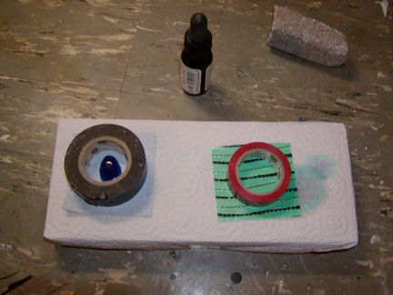

Setting up the modified boat test with SBPO on the left and gross crosswoven housewrap on the right. The gross crosswoven failed even before the “cladding” layer of the sandwich could be applied.

Benchtop version of the hydrohead test with SBPO. There is a full 22-in. column of water in the pipe, and the SBPO is not leaking (those drops of water you see is water getting around the fitting and clamp, not coming through the housewrap).
Benchtop version of the hydrohead test with gross crosswoven. The water started dripping through the gross crosswoven housewrap as soon as it was poured into the pipe.

The great thing about all three tests is that a work bench version of each is really easy to do. Paul Fisette, head of the Building Materials and Wood Technology Department at the University of Massachusetts in Amherst, was the first to adjust the ASTM D779 “boat test” to mimic real building conditions (called the “modified boat test”). Just stick a paper towel as a blotter between the housewrap and sheathing and wood siding, and press these components together as they would be in a typical wall. Then take the “sandwich” apart and see if the paper-towel blotter got wet.
See the pictures on the right for some benchtop non-ASTM versions of the modified boat and hydrohead tests. The non-perforated SBPO (translation: Tyvek or Typar) passed both tests, and the gross crosswoven housewrap (translation: Pactiv Raindrop) failed both. Building paper passed the modified boat test but is not really suited to the hydrohead test.
Bottom line? I think you need to benchtop test your own housewraps until ASTM gives us a standard that separates the wheat from the chaff. These benchtop tests are easy to do, and you can see for yourself which WRB materials hold water, literally. In my experience and benchtop testing, perforated and gross crosswoven housewraps simply don’t pass muster.
