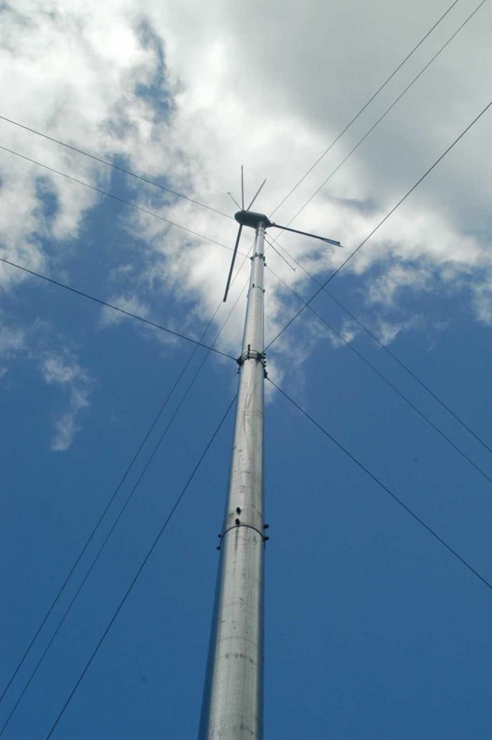

United Wind customers are people like Ed, Kevin, and Rich Doody, dairy farmers in central New York who installed turbines not only at their dairy barn but also at their own houses and saw electricity bills drop essentially to zero, according to an article in The New York Times.
Because the turbines are relatively small, they don’t generate the kind of opposition that utility-scale wind farms with turbines hundreds of feet high often do.
So far, United Wind’s customer base has been mostly in central and western New York, but the new funding will allow the firm to push into the Midwest and finance an additional 1,000 projects.
