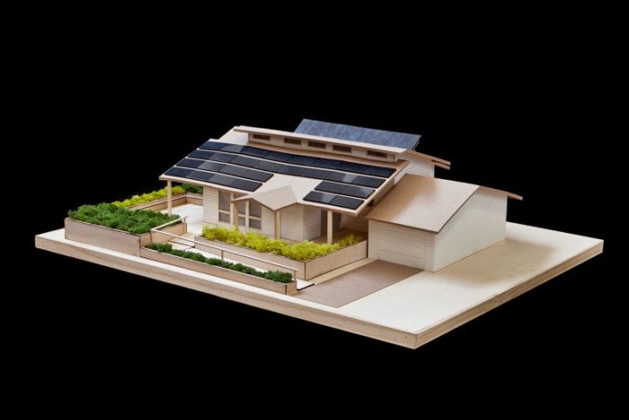

Purdue University's 2011 Solar Decathlon entry is called the INhome.
Image Credit: Purdue University

The INhome is equipped with an 8-kW photovoltaic array on its south-facing roof. A second photovoltaic array mounted on the north-facing roof of the house is angled sharply to catch sunlight. The array consists of bifacial panels mounted over reflective material on the surface of the roof. The master bedroom includes private access to a screened porch on the west side of the building. The interior features an open floor design, with vaulted ceilings in the living room and kitchen area. The ceiling is fitted with clerestory windows that can be opened to improve ventilation in warm weather.
Like most projects heading for the 2011 Solar Decathlon in Washington, D.C., Purdue University’s INhome is designed to address regional climate conditions and cultural expectations. Purdue is located in West Lafayette, Indiana, in the west-central part of the state, where traditional-looking suburban homes with attached garages find favor among home buyers. “There’s a lot of snow up in Indiana right now,” Team Purdue’s project manager, Kevin Rodgers, told Fine Homesbuilding’s Justin Fink back in January during an interview at the International Builders’ Show. “I would love to have an attached garage.” In addition to the nod to tradition, an attached garage (which, under competition rules, doesn’t count as conditioned space), and the Indiana-referenced name of the project, IN Home’s other concession to regional preference is that the building – in contrast to many other Solar Decathlon houses – is relatively deep rather than long and narrow. The aim was to make the home’s 984 sq. ft. of interior seem as spacious as possible, and to exploit the roomy feeling created by the building’s open floor design and its vaulted ceiling, with operable clerestory windows, over the living room and kitchen areas. Two bedrooms make up the bulk of the private area, and there is a centrally located bathroom connected to the home’s “wet core” of plumbing fixtures.

Leaning hard on PV INhome will rely entirely on passive features and photovoltaics for its energy needs. Power derived from an 8-kW array on the front, south-facing roof will be supplemented by a smaller, steeply angled array of bifacial PV panels mounted over a reflective surface on the back roof. Triple-glazed windows, made by Kolbe & Kolbe Millwork of Wausau, Wisconsin, will be used throughout, with solar heat-gain coefficients that vary by orientation. The house will be equipped with an energy-recovery ventilator. In mild weather, the clerestory windows can be opened to increase ventilation, and a trellis overhang that will be mounted near the large windows on the front of the house is designed to shade them during the summer months. Rodgers tells GBA that INhome’s shell will be constructed of structural insulated panels to R-24 on the exterior walls and R-50 on the roof. The panels are being made by Thermocore, based in Mooresville, Indiana. The project’s airtightness goal, Rodgers adds, is 1 air change per hour at 50 Pascals pressure difference. Once the Solar Decathlon is over, INhome will be shipped back to West Lafayette, although its future beyond that is still being worked out. “We’re not going to scrap the house at all,” Rodgers says. “We’re looking at a few organizations, possibly donating the home. But the goal is to look at it long term, see how we did with the design and performance, and wrap it up with some master’s theses and dissertations.”
