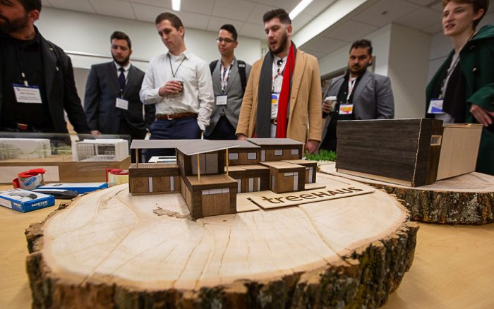

An entry from Virginia Tech called TreeHAUS was named the top winner in this year's Solar Decathlon Design Challenge. The modular design is intended to help solve a developing housing shortage at the school's Blacksburg, Virginia, campus. [Image credit: John DeLa Rosa / Solar Decathlon]

The TreeHAUS project
The real-world problem that the Virginia Tech team was trying to solve is anticipated enrollment growth on its Blacksburg, Virginia, campus that will require the addition of 7 million gross square feet of housing by 2047. That has pushed real estate prices sharply higher, a problem especially for underpaid graduate students, the team said in a project summary.
The team proposed a building consisting of 12 prefabricated modules on a 36,000-square-foot lot. Units would range in size from 1-bedroom units with one bathroom to 4-bedroom units with 2 bathrooms. The project would be built with R-37 walls and R-55 roofs, a shared 50-kW solar array, and energy-recovery ventilation. The proposal predicts a HERS Index rating of 34 without the PV array.
Other features include a variety of automated and artificially intelligent building controls, wood-fiber insulation, dowel-laminated timber components, a landscaping plan that provides food for occupants, and rainwater collection for irrigation.
The team called their project TreeHAUS after the way trees collect and distribute resources in the forest. “The TreeHAUS harnesses energy from the sun, harvests water from the rain, and cycles resources and information throughout its community in the same way that plants and trees do in nature,” the project summary reads.
