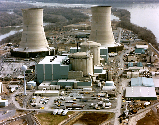

Just 99 nuclear plants in the U.S. provide one-fifth of the country’s electricity
A partial meltdown at the Three Mile Island nuclear plant in Pennsylvania in 1979 was one of the three most serious accidents at nuclear power stations globally. While frightening, the accident resulted in no health consequences to the public.
