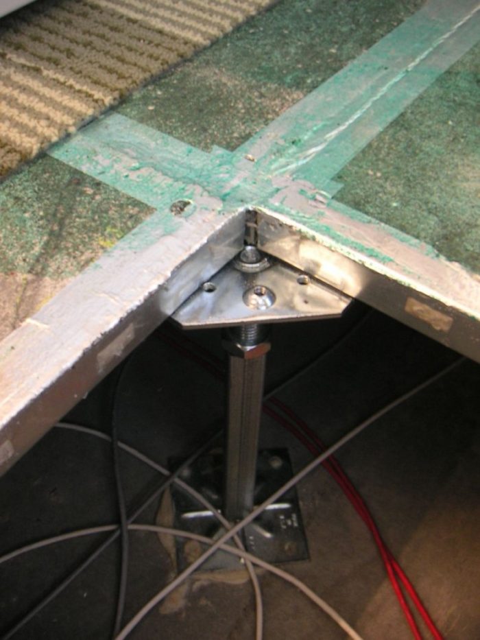

While doing research for my last couple of blogs, I read Joe Lstiburek’s “It’s the Energy Stupid.” One of the strategies that Dr. Lstiburek discounts there is underfloor air-distribution systems. Southface used just such a system for the office space in the new addition. Lstiburek states:
What’s “green” about underfloor supply plenums? How do they save any energy? They sure as heck don’t contribute to indoor air quality–they make it worse. Do you want the breathe air delivered in a ductless void under the floor than cannot be cleaned? You ever been in one? They are under everything—duh—so stuff collects in them. They have to be cleaned, but you can’t clean them because you can’t easily get at them, and you can’t easily clean them even if you get at them because they are filled with services and so they are filthy. And they are expensive. The building has to be taller. That burns up resources and money. But it’s green. Says who? More money, more energy, more resources, and more problems. What’s green about that?
To me, this blanket statement oversimplifies the issue. I call this type of response and attitude “the Dogma Syndrome,” and it plagues the hell out of Americans. In many cases, underfloor plenums are designed, installed, and maintained improperly. Why? Turns out, there’s a philosophical and sociological answer.

I’ve talked to the folks at Southface about how they were able to pull off an underfloor system that they felt good about. They told me about the very anal-retentive engineer who designed the system and how he painstakingly described proper mastic sealing of the plenum. They made sure that there were no adjacent cavity walls that could be pressurized. They utilized metal baffles in the floor to channel air flow to the intended locations. As the above picture shows, care was taken to install mastic tape at the seams in the concrete floor tiles, and the FLOR carpet tiles were offset from the concrete floor tile seams to further safeguard against particulate contamination and air leakage.
The benefits if the system include better daylighting because the distribution system is not overhead; improved employee thermal comfort due to personal controls; and a great chase for running technological spaghetti. They clean the system with a high-powered vacuum. The particulates that move get filtered, and those that sit still get sucked up in cleaning. To me this seems no different than an underfloor duct system when time and care are taken to make sure the system will function properly. The Southface folks made sure that the install went as planned every step of the way.
