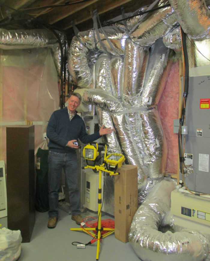

This ductopus was installed in a multi-million dollar home. This ugly duct system was not designed; it was thrown together. Chances are good that they will not get good air flow from this system.

Exhibit 1: Ductopus in a $3.4-million home
Martin Holladay, the Energy Nerd here at GBA, came to Georgia earlier this year, so I took him to see the green community, Serenbe. On our way back, I drove him by the Atlanta White House, and it just so happened that the house across the street, built by the same home builder, was having an open house. It was built for $3.4 million, one of the real estate agents said, but was listed at a mere $2.49 million. What a deal!
After exploring the lavish finishes upstairs, we discovered two mechanical rooms in the basement and the ductopus above is from the first one. The other had a ductopus, too, but not quite as impressive as this one. (And yes, that’s 6 mil poly on the basement walls. In Atlanta. They put it on the attic-side of kneewalls in the two bonus rooms, too.)
