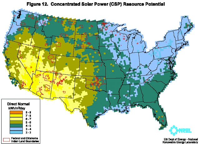

Solar energy face-off. Solar thermal and photovoltaic installations for residential and commercial buildings, and for utility-scale power generation, tend to be most productive and, therefore, cost-effective when installed in the Southwest. Some utility projects still in development have switched to PV as an oversupply of panels caused their prices to drop.
Image Credit: Department of Energy / National Renewable Energy Laboratory
