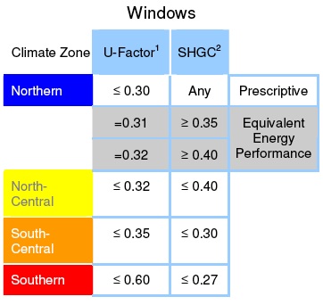

The new criteria. Energy Star qualification requirements for residential windows.
Image Credit: Energy Star

Rockefeller and Grassley, to their credit, want to peg the tax credit to Energy Star requirements that are scheduled to take effect January 4, 2010. The positive, logical thing about these new Energy Star criteria is that they are climate-specific, with, for example, a SHGC “equivalent energy performance” requirement for the northern climate zone of at least 0.35 and corresponding U-factor equivalent of 0.31; for a SHGC performance equivalent of at least 0.40, however, the corresponding U-factor equivalent is 0.32 for that climate zone.
For southern climates, meanwhile, the U-factor maximum is 0.60 and the SHGC is 0.27. Separate criteria also are established for window performance in “north-central” and “south-central” climate zones.

    The bill is a good idea as you quoted “The one-size-fits-all approach of the current tax credit fails to recognize that different regions of the country require different standards to achieve improved energy efficiency depending on climate." however your chart does not follow IECC climate zone boundaries. The country is divided up into 8 zones with differeing U and SHGC values. I hope the implementation recognizes the IECC climate zones and values not set different standards. If you think consumers and builders are confused now. Wait!
