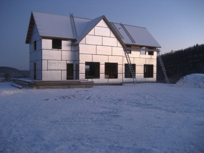

The walls of architect David Pill's house in Charlotte, Vermont, were sheathed with 1-inch-thick foil-faced polyisocyanurate. Twelve months of monitoring data show that the house has achieved net-zero-energy status.

BOSTON, Mass. — An energy-efficient house in Charlotte, Vermont, has won a $10,000 prize offered by the Northeast Sustainable Energy Association (NESEA) for the best net-zero-energy building in the Northeast. Completed in August 2007, the 2,700-square-foot home was designed by the homeowners, architects David Pill and Hillary Maharam.
Monitoring data from January 2008 to January 2009 has confirmed that the home’s on-site 10-kW Bergey wind turbine produced 17 kWh more energy than the occupants consumed. While Pill and Maraham used 6,269 kWh of energy (6,094 kWh of electricity and the equivalent of 175 kWh of firewood), the wind turbine produced 6,286 kWh.

    I agree that the Passivhaus approach makes a lot of sense. David Pill included excellent envelope details, however: 4 inches EPS under the entire basement slab; R-20 basement wall insulation; R-40 above-grade walls; and R-60 roof insulation. For windows, he chose triple-glazed Thermotech windows with two low-e coatings (U-0.17).
