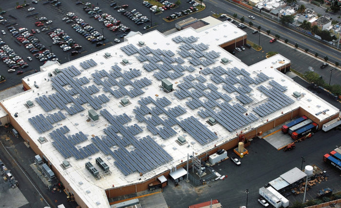

A large photovoltaic (PV) array on a Walmart store in Ponce, Puerto Rico. The Walmart store is one of five on the island with a PV installation and one of 348 in its U.S. chain of retail stores that has a PV system.

In its Solar Means Business report, the Solar Energy Industries Association says that the Bentonville, Arkansas, retailer now has 348 PV installations with a total capacity of 142 megawatts.
Next in line were industrial real estate developer Prologis, with 97.5 MW of capacity, Target (71.9 MW), Apple (60.7 MW), Costco (50.7 MW), Kohl’s (50.2), and Ikea (41.4 MW). Other companies on the list represented a variety of industries, including auto manufacturers, a drug store chain, telecom companies, and an office supply chain.
In all, the companies sampled in the report installed 1,686 PV systems with a combined capacity of 907 MW, generating enough electricity for 158,000 homes. That’s a 59% increase over findings of last year’s report, the association said.
