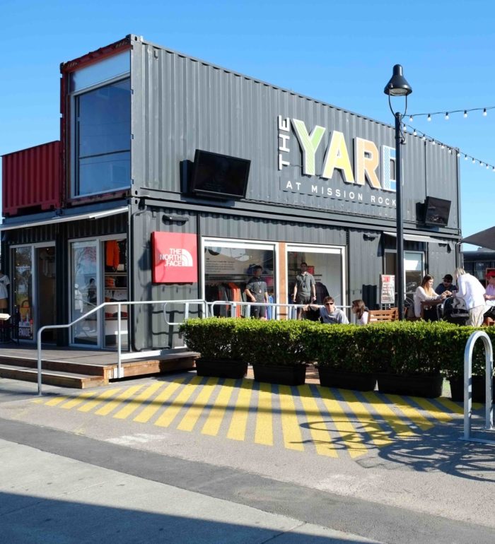

The author collaborated on this container project, a neighborhood gathering spot in San Francisco called The Yard at Mission Rock.
Image Credit: Mark Hogan
What’s wrong with shipping container buildings? Nothing, if they’re used for the right purpose.
For a temporary facility, where an owner desires the shipping container aesthetic, they can be a good fit. (Look, I’ve even done a container project!) For sites where on-site construction is not feasible or desirable, fitting a container out in the factory can be a sensible option, even though you’ll still have to do things like pour foundations on site. It probably won’t save you any money over conventional construction (and very well might cost more), but it can solve some other problems.
