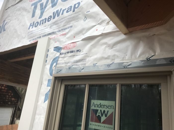

This window was not installed according to the manufacturer's instructions. The homeowner wonders whether he should insist that the windows be removed and reinstalled. [Photo credit: Brian]
Brian is building a new house in New Jersey and has selected Andersen 400 Series windows. So far, so good. The problem is how the windows have been installed by Brian’s builder.
Many of the manufacturer’s installing instructions have been ignored, Brian writes in a Q&A post. The contractor used no caulk, chose Tyvek housewrap tape instead of flashing tape, and failed to overlap the Tyvek by at least 6 inches, as required by the instructions.

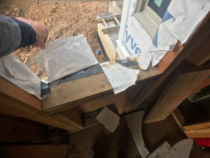

“It looks like they lined the rough openings with Tyvek and a bit of Vycor Plus flashing at the botton only, then installed the windows without caulk, then installed a layer of Tyvek across the tops of the windows, and over the top nailing flange, then taped the flanges with Tyvek housewrap tape,” he says.
In an earlier post on the same topic, Brian outlined what he believed were the shortcomings in the builder’s installation methods. When he asked around for advice, the replies were not encouraging: One certified Andersen installer told him he was convinced the windows will leak.
“My builder says the windows are fine,” he wrote. “They have installed thousands of them like this, he says, and never had a problem. He very much wants me to drop the subject.”
What’s the best course for Brian to take now? Should he insist that the windows be redone? “I am prepared to redo,” he says, “but given the cost I would like to be certain that it’s really necessary.”
Brian’s painful predicament is where this Q&A Spotlight begins.
It shouldn’t cost you a dime
The building code requires that all materials be installed according to the manufacturer’s instructions, GBA editor Martin Holladay says, so the cost to Brian should be zero.

    If you have a documented list of omissions or errors regarding the installation of the windows (according to either the instructions from the window manufacturer or local building codes) and the builder insists that what he did is acceptable and "the way he's done it for years and there's never been a problem" then sum up what you wanted done and what he actually did do when installing the windows and have him sign it. Turn it into a legal contract stating that if his changes to the recommended installation guidelines results in future damage to the home (from leaky windows or missing flashing) then he has to pay for it. See if legally he will stand behind his work.
    On a separate point, if you had concerns about whether he was going to follow the proper instructions for installing the window (and I suspect that the reasons you had concerns was because of concerns you had seeing him do previous work on the house - either framing, insulation or mechanicals, etc) then you should have been on site and watched him completely install one window. Video tape the install to prove what he did. If it's not what you want then tell him that's not acceptable and fix that one window before letting him install the rest.

    Since I teach building science to Architects, contractors and engineers I thought I might put this into some perspective as it relates to a class I recently held attended by 51 contractors. I asked the class how many installed windows as a regular practice. 51 hands shot up. I then asked the class how many have ever read the manufacturers instructions on how to install windows. Zero hands went up. I then asked the class if they knew that the top (5) window manufacturers required the windows to be installed according to their specifications or the warranty was void. Zero hands went up. Does that put things in perspective?
    When we discussed the "why" the answer was basically that the contractors stated they had been doing this for 20 plus years and their way was the right way. They all said they were "taught" the right way to install a window. I did get a commitment that they would all read the instructions from now on.

    Great topic, sorry I’m late to the party. This occurs every single day in our industry and as Peter notes more often than not it never proves to be a problem. When it does however it is a big problem! There’s no doubt about it windows have changed over the last 30 years. Anyone who brags that they’ve installed their windows the same way for 30+ years is actually admitting their fault to you.
    My apologies if this was discussed and I missed it but I would suggest not doing anything until you talk to Andersen. If you look closely at the warranty it may be useless once the windows are reinstalled. Not to be the bearer of bad news but the expense here may be far greater than sealant and flashing tapes. It is entirely possible in order to protect your investment the entire order will need to be re-manufactured at the factory. Right wrong or otherwise I would find out for sure before you take any action. Good luck!

    I had this stituation 10 years ago. What I did was cut and paste, meaning I cut the Tyvek around the window, preserving all Tyvek non-window areas. Then I sealed around the window flange and CDX plywood with Grace on the window sides, then the top of the window, leaving the bottom open for drainage. Then I went back and added Tyvek around the window where it was removed, overlaping the Grace and taping with Tyvek tape. When I started final Tyvek repair step, I made sure the top went under the upper layer of Tyvek left from prior install. The last step was I fired the help.
  13. Expert Member
    Peter Engle | | #18
    James,
    That doesn't preserve the window warranty, and it doesn't really fix the problem with the lack of sill pan flashings. if you get any leakage through the window sills (a common issue), you've got no protection against that water leaking into the walls. You are definitely better off than if you did nothing, but you're still not all the way to the durability of a proper installation.
    This is all so frustrating because it is not all that difficult to just do it right. We've known about this stuff for decades. Why is it so difficult to just do the right thing?
