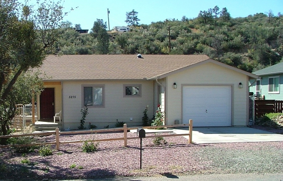

Image Credit: Tony Grahame Image Credit: Toshi Woudenberg TOP 25% OF AMERICAN HOUSES: 40.8 MMBtu/year. There's nothing particularly complicated about this home - it's just built very well. The large crew of student laborers from the Yavapai College Residential Building Technology program may have made it easier to find every possible air leak in this thoroughly sealed, mechanically ventilated home. But that's not to say that a well informed, concientious contractor wouldn't be just as succesful at building an affordable, energy efficient home.
#Typical Looking, Uncommonly Efficient and Healthy
This rather typical-looking single-story ranch house is very uncommon in a lot of ways. It’s super energy-efficient, it has superior indoor air quality compared to most new houses, and it cost $55/square foot to build.
That it was so cheap to build flies in the face of conventional thinking about green building. How was this done? Tradeoffs. Fewer studs means more room for insulation. Roof overhangs and quality windows mean a smaller AC system. An unvented roof means the AC and ducts can go in the attic.
